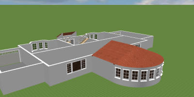

I am having problems getting a roof to fit onto a semi circular wall.
I had thought i could just import the the triangle multiple times, each time rotating it further, but after approx 20 imports i have to concede
that i cannot do it.
Heres the sh3d for the roof
Roof SH3D
any assistance or advice would be greatly appreciated
Thx Mike

It looks like the envelope of a half cone, isn't it?
Maybe, it's time to learn boolean modeling in Art of Illusion wink
Attachment halfCone.obj (2495 bytes) (Download count: 243)

Perfect my friend thank you biggrin

Nice smile
Actually, Okh proposed one here too, but thicker. With the orientation of your design, I didn't realize it could have fit.

Thank you Puybaret and thank you Okh
I had already tried the conical roof (full) and the section from 330 roof module, unfortunately none of the seemed to texture quite as i wanted, but the 1/2 cone did once orientated.
Cheers Mike
