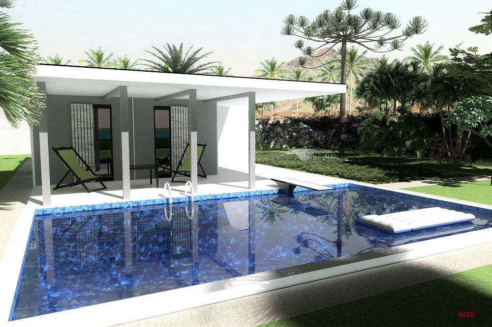

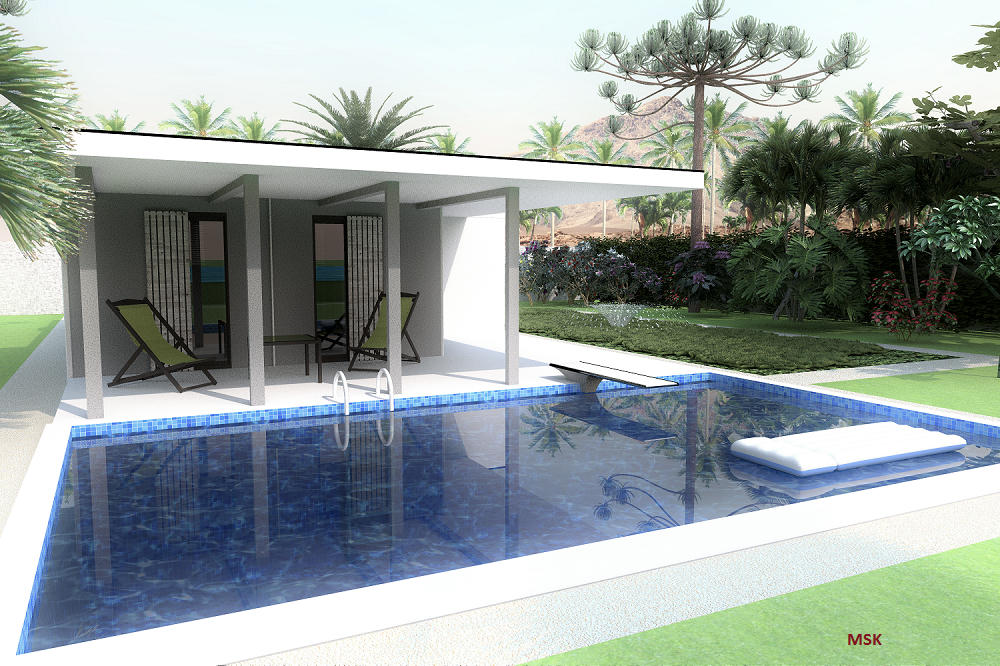

Re: Some examples using the indirect light
Hi @enkonyito
Here I have some experimental pictures using indirect light for an external view. Just for try different settings. Here is the first one I made this summer without using indirect light.
settings ...GI=default,DB=1
Now I came back and try to made the similar scene with indirect light setting....
sA=bucket
filter=bspline
AAmin=1
AAmax=1
GI=PATH
DB=2
sS=silk
size 4000x2667px...then resized to 1000x667px
/you can see that roof is not super antialiased biggrin / but the picture "look" is really different...I can only say that for my personal feeling it is too much color there but sure you can change it in postprodiction
and here I have the third one...
sA=IPR
GI=PATH
DB=1
sS=silk
but I use setting "enhanced external brightness" and then enhanced the highlights in postproduction /only for try/ and the result is here
size 7000x4667px...then resized to 1000x667px
I didn't want to post the third image here cause I changed it for a little in postproduction but for me it looks most natural smile ...not sure if it is interesting for you or for other users but for me it is nice exhibition how different can the same scene be with using different 1.3.1 settings
[Sep 22, 2016, 4:36:22 PM] Show Printable Version of Post    View Member Profile    Send Private Message [Link] Report threatening or abusive post: please login first  Go to top
Surely, I prefer the third ! applause

enkonyito
Joined: May 28, 2015
Post Count: 607
I also find that the rendering of the 3rd image is best. Nice work Martin!
...not sure if it is interesting for you or for other users but for me it is nice exhibition how different can the same scene be...
As you can see here , some users are interested in this kind of test. It would be possible to create a thread dedicated to it.
