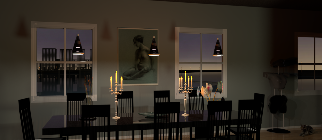

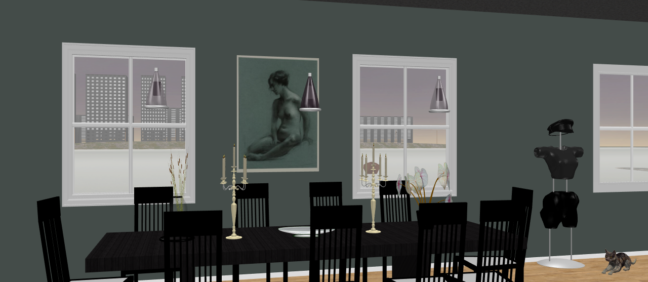

My renderings no longer match the preview-window. Far-away objects appears to be shifted, and are not rendered in the right position.

yes I changed back to 5.1, of course, so that's not the problem.
The reason I'm suspecting the rendering routine, is that it the render window seems to have changed slightly with 5.2, and that the problem does not exists in 5.1.
But, of course, there might be another explanation.
Here is what I mean:
If you look closely, you can see that the background has shifted quite a bit.

There are no lighting differences. It's the placement of far away objects that shifts.
On the top picture, made in the lowest quality, the outside scenery is at the intended position. But in the bottom picture, you will notice that the outside scenery has shifted a lot to the left. The buildings that appears in the middle window in the top picture, is appearing in the left window after rendering.
This does not happen with 5.1.
Another thing:
When I opened the 5.2 file in 5.1, the far away buildings were not there at all.
