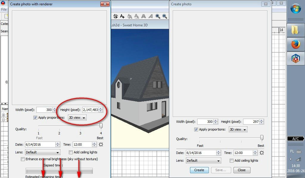

Your plug-in is great but I encountered some issues.
1) When "Apply proportions" is set to "3d view", changing image width to any value always makes height = 2,147,483,647; new height value makes width = 0.
Switching back from "Square", "4/3" and other proportions presets (that work fine) also causes this unwanted effect. If I want my image to keep proportions of 3d view but I need to change size I have to do it via standard "Create photo" window.
2) "Create photo with renderer" window doesn't fit to my screen height(1024x600px) - I don't see "Create", "Save" and "Close" buttons, even if I move or hide task bar. I use Tab key but I have to carefully count hits to avoid accidental skipping "Save" button when I'm finally satisfied with my image.
screenshot
I would be grateful for fixing it.
I can not reproduce it even by displaying the 3D view in a separate window.
Is this occasional or systematic?
Have others met the same kind of problem?
This will be fixed in the next version of the plugin that will be soon available.

I can not reproduce it even by displaying the 3D view in a separate window. Is this occasional or systematic?
- With 3D view docked (in main window) everything works fine.
- When I open "CPwR" first and then detach 3D view - it also works fine.
- Problem occurs every time I open "CPwR" when 3D view window is already floating(in my case - almost all the time). What I forgot to mention in my previous post - resizing this floating 3D view window manually(dragging edges) makes no changes to width and height fields in "CPwR".
Apparently, only me and I wink have met this problem - it happens on my both laptops - WinXP and Win7(32-bit).
By following your procedure, I was able to test the bug and find a solution. smile

Version 1.3
- Added advanced settings for rendering properties
- Enhancement option to external brightness (sky with or without texture)
- Fixed a 3D view management bug in a separate window
- Fixed a photo panel resizing bug for small screens
- Other minor fixes and improvements
