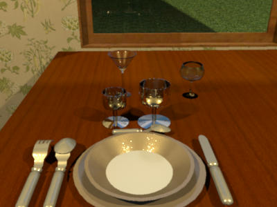

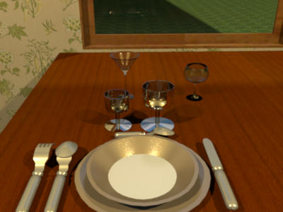

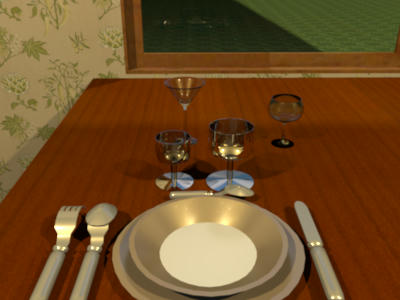

Maz,
In theory, 1024x over-sampling using (aa = 5) should result in even additional improvement
I decided to try this out. Indeed it works, but you have to be patient.
Even this small 400x300 pixels image took several hours to render with settings aa=55. Especially the glasses take VERY long. See below for results.
aa11
aa33
aa55
[Edit 1 times, last edit by hansmex at Feb 19, 2016, 6:26:42 AM]

Thanks for the tests! I suspect my problem is memory size; I'm still running 32-bit XP on this machine, and the one time I gave it several hours to process, the render routine simply returned the 'start' button active, which SH3D appears to do after some types of failure. (I have a garage door object I brutally hacked into size with Sketchup in the days before I knew how to use Sketchup, the mere presence of which anywhere in a home plan manages to kill any render of any scene in the plan.) As best I can tell -- and I've only looked at the stock SunFlow source, not the bugfixed version Emmanuel includes -- any value greater than 5 is set to 5, so that should be the maximum over-sample available.
I think I've identified where the potential problems with aa = 11 arise, but I'm up against my current understanding of vector math *and* Java syntax, so I need to study some more before I can move on.

A few stats...
- Image size was 400*300 pixels
- Render time estimated 3 hours on a six core machine, no other jobs running
- SH3D assigned 4.0 Gb of memory (but declares only 3.6), of which during rendering 2.5 Gb was used
Impressive stats for such a small image.
