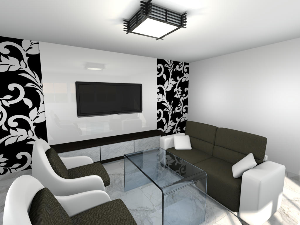

Thank Enkonyito a lot,
this plug-in helped me solve my question: "how to put shininess on furniture without reflecting the lights". Now I can set "shiny" on object such as TV screen without lights on it. We can look at the TV screen and the wall behind to see the effect.
Here is my image:
