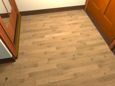

Baseboards: Much appreciated. I'm very happy not to be hand-positioning baseboard and corner mouldings; I'm hoping it will also reduce somewhat the throw-weight of my plans and the frequency with which my attempts to render crap out. I have a thing against rectangular baseboards in real life, but they look decent enough in the renders. I'd say 80% for appearance (as compared with, um, more molded moulding) and 500% for ease of use -- so a definite win.
However, they don't seem to work correctly with all doors, yet. Treating them as small walls means door depths have to be increased by the depth of the baseboard, which in some cases results in an unnaturally deep door frame protruding from the wall. I haven't tried creating a wall with baseboard and then adding a door, so I'm not sure if the door defaults to (width of wall + width of baseboard(s)), but when adding them to an existing room, I had to hand-tweak every door.
In addition, I couldn't get them to work at all with two doors. One was a slightly unusual import from 3DWarehouse: One of the Kolbe models, it's only framed on one side of the model, which may have confused sh3d's automated SVG knock-out creation. The other was sh3d's standard 'door frame' model, which I could never get to knock out the baseboard.

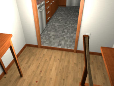

With rooms and walls created using the second beta, I couldn't break it: Baseboards worked as advertised.
With a plan created under 4.6 and modified and saved using the first beta, I get this:
Maz

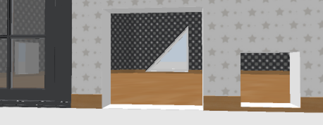

As long as DIY 3D model, you will encounter this problem.
Doors open outwards have a problem
Doors open inwards no problem
[May 31, 2015, 2:28:34 PM] Show Printable Version of Post    View Member Profile    Send Private Message [Link] Report threatening or abusive post: please login first  Go to top
Re: Sweet Home 3D 5.0
OPENING PROBLEMS
Maybe I do not get the point, but now I have tried with numerous doors and windows. Catalogue ones and different models where I specified the door properties (sash, svg, etc). As far as I can tell, the baseboards work perfectly. Never seen the phenomenon mentioned. Could there be something with the models?
