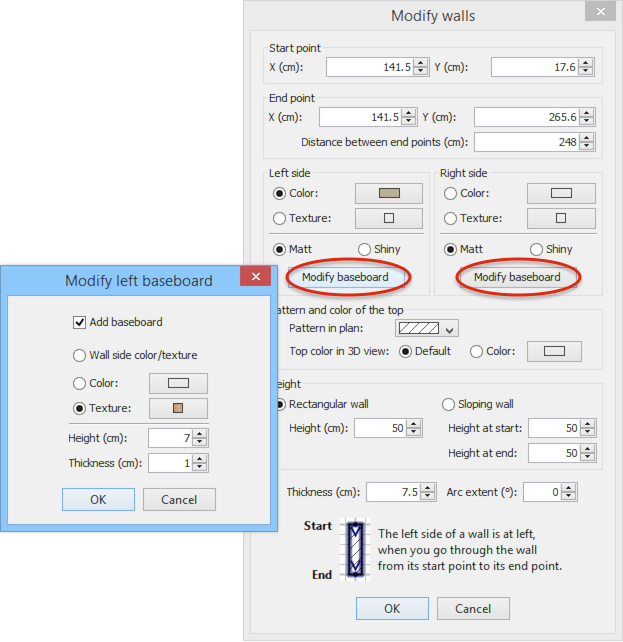

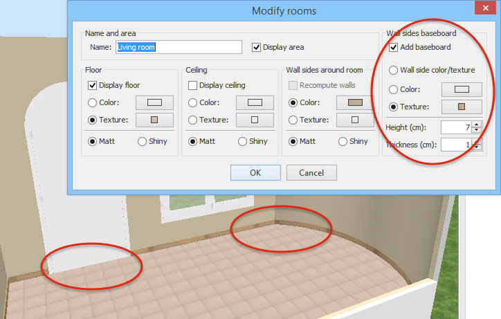

The Beta 2 brings... baseboards smile
The room modification pane and wall modification pane were modified to let you select the baseboard you want on the walls around a room, or on each side of a wall.
You can add a baseboard along straight or round walls, choose their height, their thickness, their color/texture or use the same one as the color/texture used for their wall side. Baseboards are cut by doors and windows that intersect the wall along which they are set (actually, baseboards are computed more or less as small walls in the 3D view). Their profile can be only rectangular.
Objects with no elevation are magnetized along baseboards sides instead of walls sides when they are moved around. As soon as their elevation is greater than zero, they will be magnetized along walls sides without taking into account its baseboards.
Baseboards are not drawn in the plan. If ever you think they should be drawn, please give your advice about how they should be represented and why. Maybe I'll change my mind...
One last thing, you can also use baseboard to cover a part of the wall with an other color or texture if you set a big height. That should make it easier to add tiles on top of kitchen cabinets or around a bath.

Baseboards: Much appreciated. I'm very happy not to be hand-positioning baseboard and corner mouldings; I'm hoping it will also reduce somewhat the throw-weight of my plans and the frequency with which my attempts to render crap out. I have a thing against rectangular baseboards in real life, but they look decent enough in the renders. I'd say 80% for appearance (as compared with, um, more molded moulding) and 500% for ease of use -- so a definite win.
However, they don't seem to work correctly with all doors, yet. Treating them as small walls means door depths have to be increased by the depth of the baseboard, which in some cases results in an unnaturally deep door frame protruding from the wall. I haven't tried creating a wall with baseboard and then adding a door, so I'm not sure if the door defaults to (width of wall + width of baseboard(s)), but when adding them to an existing room, I had to hand-tweak every door.
In addition, I couldn't get them to work at all with two doors. One was a slightly unusual import from 3DWarehouse: One of the Kolbe models, it's only framed on one side of the model, which may have confused sh3d's automated SVG knock-out creation. The other was sh3d's standard 'door frame' model, which I could never get to knock out the baseboard.
This probably screws up and/or unnecessarily complicates your 'small wall' model, but my preference would be to treat baseboards as having no depth when calculating door or window cut-through. That is, if (depth of door >= wall thickness) then do not display baseboard.
(I'm also fond of leaving the stub end of walls sticking out. At the moment, these aren't baseboarded automatically, but to do so manually is a trivial fix.)
