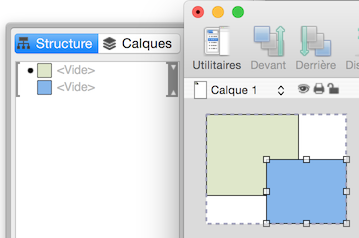

- in OmniGraffle, selecting an item in a group is done the same way as in MS Word, but a selected group and an item selected in a group are displayed differently (white vs grey background around the selected group, and light blue line vs dark grey dotted line, like in the following screen captures):
Once the item you want to change is selected, OmniGraffle lets you resize it with the mouse but not move or rotate it (you can still edit its location and angle with a separate dialog).
MS Word doesn't handle changes of subgroups and you can subselect only final drawings (but changing the size of such an item will alter the size of the subgroup it belongs too). OmniGraffle lets you select a subgroup by clicking on it like other items. Then, if you want to select an item in that subgroup, you have to click again on that item (a little like if you want to unbury it). Once selected, the selection rectangles appear like in the following image where you can see that the white background is reserved for the parent subgroup:

OmniGraffle proposes that list but you can't select an individual item in that list, and an item of a group selected in the main window isn't displayed as selected in the list (see in the following image):
I don't like too much this lack of synchronization in selection feedback between the main window and the list of drawings, because it feels a little buggy.
