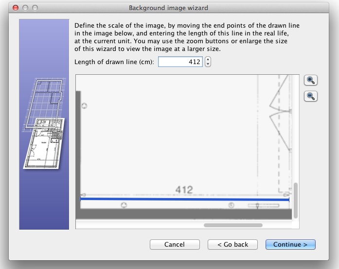

The Beta 10 brings the ability to zoom in and out in the scale and origin steps of the background image import wizard. This should users to help them enter the scale of their background image with more precision.

Emmanuel,
That works great! Very useful!
Could you maybe add another small feature?
Constrain the scaling line to horizontal by holding the SHFT or CTRL key? Maybe add 15 degree increments?

Perfect, this is useful. This example shows just how useful.
I tried to do this building on a laptop, near impossible before.
(It is probably not a bug, but FYI: on a WinPC CTRL-ScrollWheel does not zoom in this window. And in the 2d window, CTRL-ScrollWheel also does not work when drawing walls or rooms. But this is not new to sh3d 4.2)
I added an horizontal/vertical constraint when SHIFT key is pressed in the Beta 11, but won't go further at this time.
