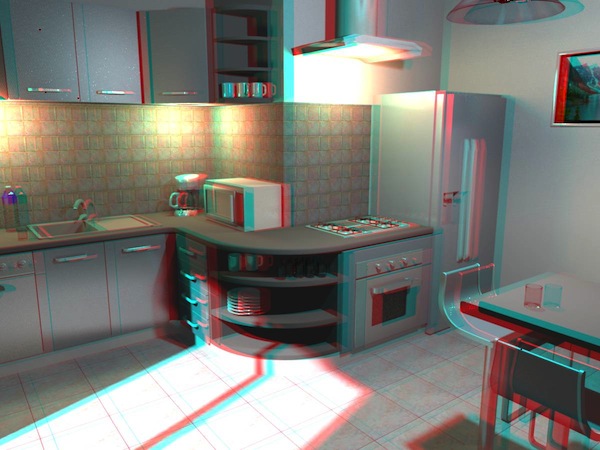

I tried it at the Kitchen point of view of SweetHome3DExample7.sh3d file then generated an anaglyph imagewith StereoPhoto Maker, and it worked very well.
Larger image
