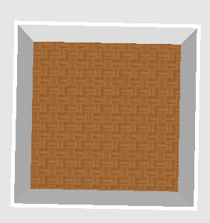

Yes, I have read the user's guide and followed the procedures just as you described but I am still not getting the effect I want. Do you have a picture of your 3D model with realistic hardwoods. I would love to see it. Also, as far as the size of the texture is concerned I have changed it from 1" to 20' and everything in between...still looks like tile. If anyone with suggestions on how to do would this please include a picture of your successful attempt I would really appreciate it. This is what I get:

This texture gives the result below (if imported as 60x60 cms).
