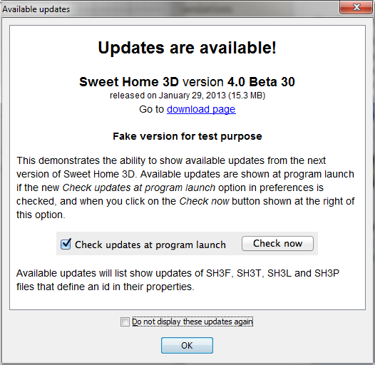

The beta 11 brings the new Check updates at program launch option in the preferences pane along with a Check update button to get information about program and SH3F/SH3T/SH3L/SH3P files updates.
To let you try it with the current Beta, I published some information about a fake version 4.0 Beta 30 that will show the following dialog at program launch.
The updates dialog displays also a Do not display these updates again option shown only at program launch, that avoids you to get the shown updates again at next launch. If you select the check box, the updates dialog will appear again only when newer updates are available.
Of course, in the real world, this new option will have some effect only when version 4.1 will be released, but also for the next beta versions.

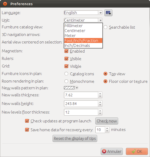

Here's the Beta 12 with the following features:
- Existing Inch unit was renamed as Foot/Inch/Fraction, then modified to always display the closest eighth inch fraction for lengths shown in the furniture table and in the plan, and to remove decimals for areas expressed in square foot.
- The Inch/Decimals unit was added to preferences Unit choice, and displays decimals of an inch for lengths shown in the furniture table and in the plan, and for areas expressed in square foot.
- The shortcut of the 3D view > Display in separate window / Display in main window menu item was set to ctrl + alt + Y (cmd + alt Y under Mac OS X) and program shortcuts were enabled in the separated 3D view.
- Line thickness was reduced in prints and PDF files (this feature was already programmed in previous Beta but I forgot to mention it).
As the following screen capture shows, Unit radio boxes were replaced by a combo box proposing the 5 available units.
If there are some users of the Imperial system (i.e. foot/inch) reading this message, I'll be pleased to know their opinion about the unit change. It was a request of some users and I tried to program a logical solution that could be easy to understand. But as a Metric system guy, I could have missed something...

Am I getting it right: the automatic update detection will include beta releases as well?
Yes, but it depends on the deployment solution you use. In many cases, Java Web Start updates automatically the jar files required for the program when they are more recent. In that case, you won't see the updates information since the program will be already updated to latest version once launched!
