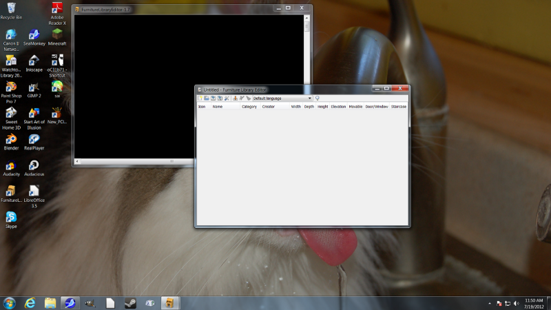

Another question:
Why are there 2 windows, one that looks like a terminal and the other being the desired FurnitureLibraryEditor?

Re: FurnitureLibraryEditor 1.7 on Windows 7 cannot launch
I wanted to add a screenshot and I hit the wrong button, lol.
Trying again:
[Jul 19, 2012, 4:57:23 PM] Show Printable Version of Post    View Member Profile    Send Private Message [Link] Report threatening or abusive post: please login first  Go to top
pencilart
Joined: Oct 2, 2007
Post Count: 188
Sorry about this,
trying the screenshot with a link:
[Jul 19, 2012, 5:01:31 PM] Show Printable Version of Post    View Member Profile    Send Private Message [Link] Report threatening or abusive post: please login first  Go to top
