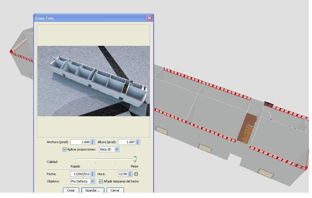

Hello to everybody,
If I create a photography at level 3 or 4 I get a result full of shadows around the building (floor grey/dark)and a very bad resolution, during the process of the project I work step by step saving every couple of hours my work on diferent files.
Starting a new project from cero I don´t have this problem but after some modifications the problem appers and then is thear for always.
Any idea??

Sorry, I have not been clear with my explanation,then...
You know how can I add a picture of the problem on this post for show you better the problem?

Here you have¡¡
Thanks a lot

There you can see that the 3D view is a clean view without shadows.On the photagraphy, you can see how are the floor shadows and strange figures never I designed or planned.

This may happen if the building is very very very large.
Can you check the size of your plan? From the image you posted it shouldn't be larger than 100 meter long, and the effect you reported should happen if it's larger than 500 meter.
If you work with imperial system, maybe you mixed feet and inches.
