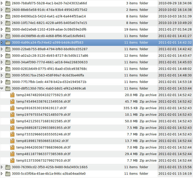

A small update on my crash problem.
I can draw a set of walls, apply colours/textures, save it and then re-open it.
I cannot insert furniture into that file. Not before saving, not after re-opening.
I also cannot open previously saved files that contain furniture.
All the other directories you see in the picture contain multiple files, all with sh3f files in different sizes. The sizes have nothing to do with what I tried to insert: they are far too big for that.
Example: the first file (starting with temp246748200) contains 49 directories with obj/mtl/png files (no jpg's), and 49 png files. It looks as if the program tried to insert them all at the same time and then crashed? The strange thing is that my subcategory Plants contains only 30 plant models. Strange also is that on my harddisk, the subdirectory Plants (in my subdirectory 3dmodels) also doesn'y contain 49 models. So the question is... Where does SH3D find 49 models, that I cannot find?
Example: the second file (starting with temp745494338) contains all my models of people, and follows the same structure as the file I mentioned before.
I hope this helps.
[Feb 1, 2011, 11:15:37 PM] Show Printable Version of Post    View Member Profile    Send Private Message [Link] Report threatening or abusive post: please login first  Go to top
Re: SH3D crashes after Ubuntu 11.04 update
Hans, I don't think you look at the right place.
work subdirectory contains only temporary files used by Sweet Home 3D. These files are deleted when the program exists normally or when they are older than a week for a given version of Sweet Home 3D. If you want to, you can empty work subdirectory safely after you quit Sweet Home 3D.
The many SH3F files you see there are simply copies of the files in furniture subdirectory. Sweet Home 3D is obliged to work on copies of the original SH3F and SH3T files, if I want to let the user to update them without relaunching the program.

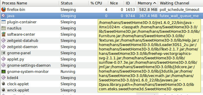

I don't know where else to look.
I tried starting with OpenJDK Java, but that doesn't give any result (I think).
When using the Sytem Monitor, there is a popup window with a lot of information. Maybe that info is useful for you?
