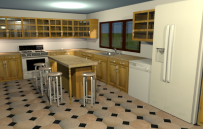

When I render the scene (using the Best or next to Best setting) There is now a huge light/white spot on the ceiling. I used the Halogen light (the same light that was used for the beta tests) and have it set to 25% power. I hadn't noticed the spot on the ceiling caused by the light before. Is that a new problem? I'll have to play around with the other lights to see if that still happens.
I'll attach a rendered pic to show you.
Attachment kitchenSH3D3-0.png (199559 bytes) (Download count: 812981) (Notice strong light on ceiling. I have even lowered it so that it's not right up against the ceiling.)

Wouldn't you have forgotten to unselect Add ceiling lights check box?

That was unchecked already. I can attach a screenshot of that if you like.

Indeed, lights tend to show bright white spots on ceilings, especially if the light is placed closed to the ceiling. There are a few things you can do:
- place the light lower, obviously;
- make the light larger, so that it seems softer;
- make your ceiling (and walls) Matte so that the bright spot is not, or less, visible.

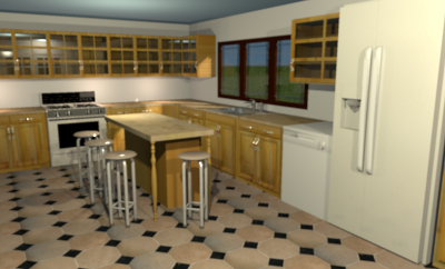

ok, I'll try those things. Thanks!
Edit:
the light is now 4 feet 6 inches (I guess that means from the floor?)
the ceiling was already set to matt
the light is now huge, lol, but it does now look softer.
Attachment kitchenSH3D3-0again.png (188194 bytes) (Download count: 816430) (light is now 4 foot 1 inch wide and 4 feet in depth.)
