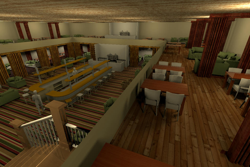

Another picture of the restaurant with gallery. It's about time to hire a chef!

Nice work there hans....really nice floor texture for the gallery...but i dont like the roof texture...

The nice thing about SH3D is, that you can design your own restaurant, with all your favourite textures! laughing

ya! i meant that that was carefullt designed ..i guess you know what i actually mean laughing
