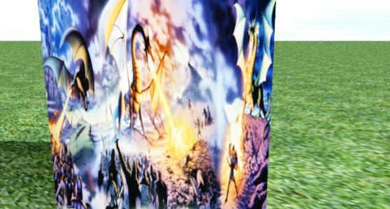

I did kinda exactly this... let me make some screenshots.
Lets say I use a picture of the Niagara-Falls and want to give it a new texture so I can put on another image
next I import the texture and gives it the size of the actual poster (which is 157cm width and nearly the 49,95cm it says (actual its 53cm height, but thats due that this is a image))
now I change the object to match my needs
after what you have said it should work now, but look yourself:
but the image looks like this
So you see there is a point in the object where it tiles the texture around it.

Re: using own textures to show posters?
Either use the other side of your box, or reduce its depth to a very small value.

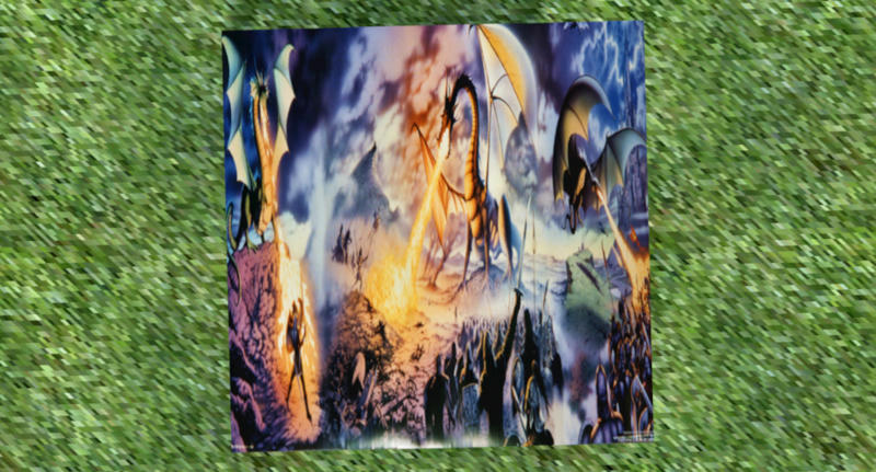

I think you are trying to make a picture frame for your wall am i right?

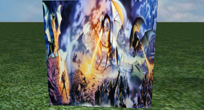

Well i also have been thinking on asking Puybaret if he could make a frame where any picture can be inserted by changing the texture but i found another way using box to create own frame so i dropped out the question.....here is a picture frame with the picture you posted.
Picture Frame
There is a pattern how the texture in the box works:
1. on one side of the box ( lets say back) the texture is applied as a reflected image so you get a image opposite than the image you chose and it is same for bottom part also.
2.And on other side( i.e front) it is same like the picture and on the top also it is same.
FRONT:
TOP:
3. other two sides do not take texture..
so keep that in mind if you like to create a picture frame of your own..
