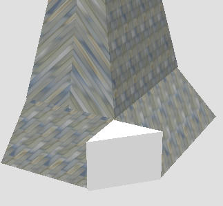

Hello all,
It's easier for me to answer a 100 questions on this forum, than make one simple, although special, triangle. I spent several hours with Art of Illusion and Misfit 3D, but without success. So, who can help me?
What I need is a "triangle" that fits in the corner of the model in the image. Basically the top horizontal line of the white triangle should be merged with the bottom horizontal line. The resulting model has three equal faces measuring 1.00 x 1.00 x 1.414 cms/units (and corners of 90, 45 and 45 degrees), and a diagonal face measuring 1.414 x 1.414 x 1.414 cms/units (and three corners of 60 degrees). The 1.414 is of course an approximation of the square root of 2.
Thank you VERY MUCH in advance.

Maybe I should call it a special tetraeder? Not one with 4 equal sides, but one as described. I already have the "original" triangle imported in every possible orientation, because I use it as one of my basic building blocks.
I would also be happy with a model that looks like a quarter of a cone, because that would also fit in the corner of the model in the image. (or even better: both)

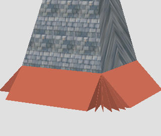

Like this??

Did you already make it? Or is that just what you want? That looks like a roof. smile
