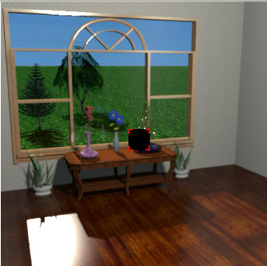

Rendering with version 3.0 beta 12 in highest quality didn't cause any problem. I'll try to attach an image, but Mediafire (or my internet connection) is causing trouble.
I noticed one strange thing: the blue flower in the middle of the low table didn't show in the 3D preview, but rendered OK.

It's a strange file, though... I closed SH3D and started it again, just to see if I could reproduce the "white box" that replaced the blue flowers. First Q3 render didn't finish, it ended almost complete. Second Q3 render doesn't finish either.
Two little squares, one red, one green, are used as progress indicators. What happens both times is that the green indicator makes its spiraling motion to the end. But the red one doesn't move and stays in the centre position. The result is that you can't save the picture.

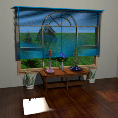

Only change I made is t hat I moved the blue blinds to another position to better admire the view.
