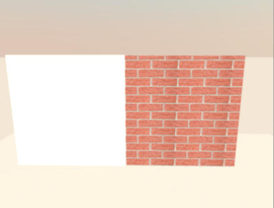

@Sebastien,
This is the result your file gives me using v3.0 b12 in quality setting 2 and 3.
@Emmanuel
The left part is the imported model; the right part is a wall.
Blackmann-Harris = Q2 and Q3 same results as picture above
Catmull-Rom = Q2 and Q3 both parts textured; no difference in shading between wall and model
Mitchell = Q2 as picture, Q3 both parts textured; no difference in shading
[Oct 13, 2010, 4:57:10 PM] Show Printable Version of Post    View Member Profile    Send Private Message [Link] Report threatening or abusive post: please login first  Go to top
