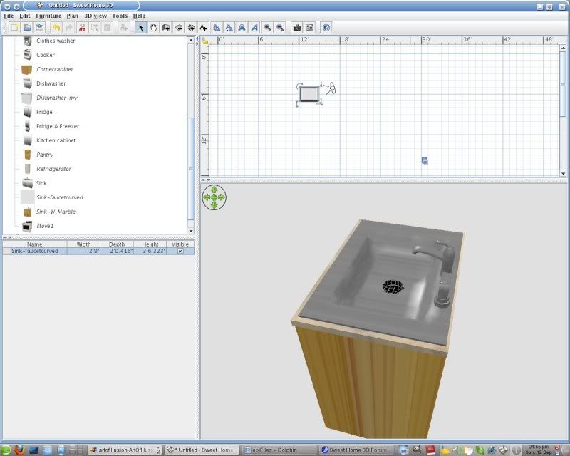

Re: Is this a bug?
Yes it's a bug. I tried to program image creation using different ways and compatible with the systems where offscreen imaging isn't available. At this time, it's some kind of automatic screen capture. If it fails, please modify the imported model by double-clicking on its icon in the catalog and just pass the 4 parts of the wizard.
