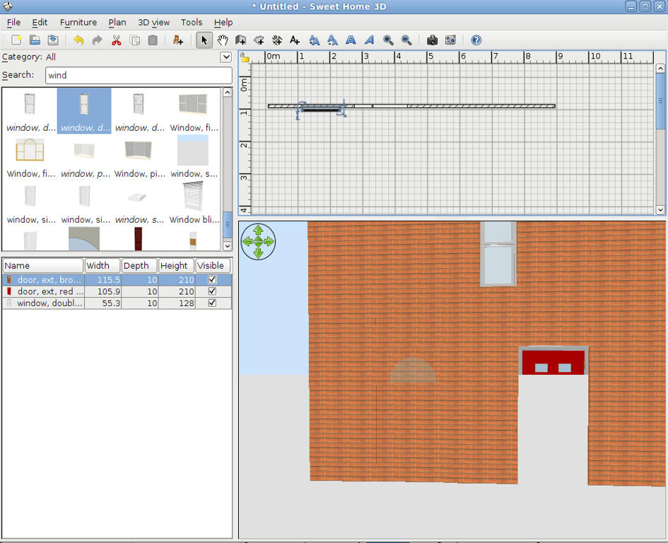

Emmanuel, db5tech,
QUOTE
The other problem has something to do with refreshing the screen. When I drag an inserted door out of the wall, the door disappears and only the glass window in the door remains visible. When I do a right-click and (without selecting anything) a left-click, the screen refreshes correctly.
ENDQUOTE
Maybe it's a driver problem, I wouldn't know. Just seems that the refreshing isn't as fast or automatic as it should be. The right-click left-click solves the issue.
As for Ubuntu: I'm using Lucid 10.04. It recognizes that Windows is already installed and proposes to do a dual install, so that you can choose at start-up. Of course you can also install it on a virtual machine.

Hi Emmanuel,
Just download the install version of 2.6 and tried your MultiLevelWindows.sh3d file, it works perfectly! smile
Hans,
I tried adding a door with glass, then moving it in and out of the wall, the door still appears correctly.
Thank you from one very happy user!! smile
