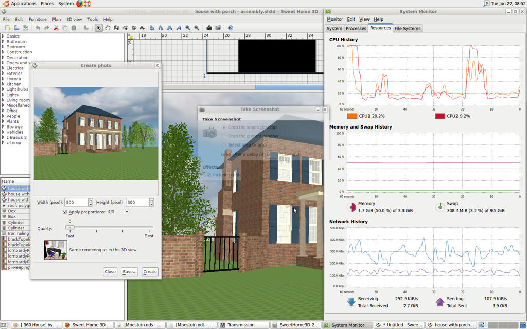

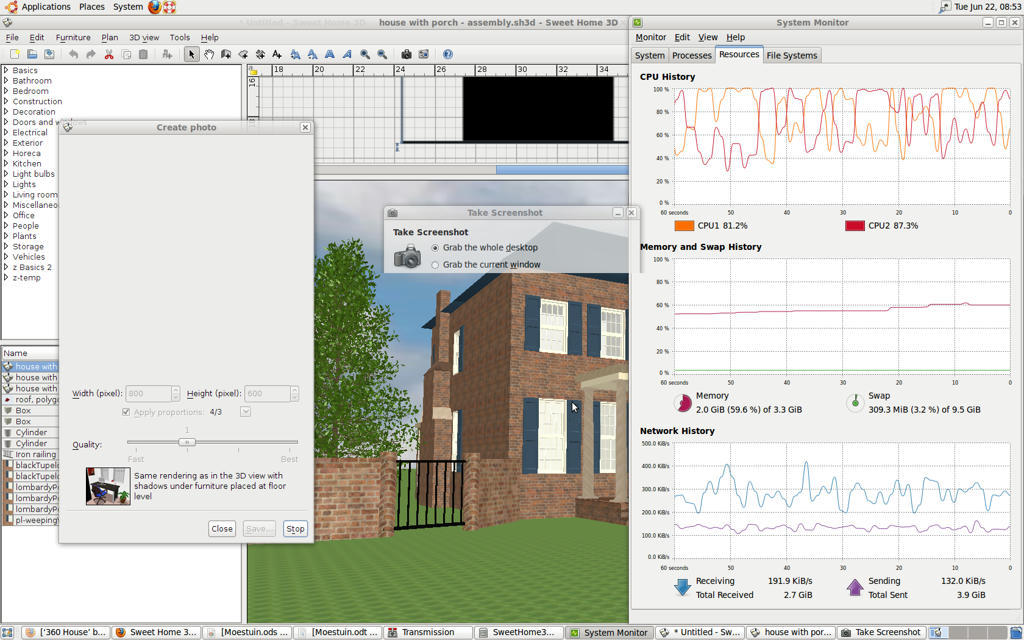

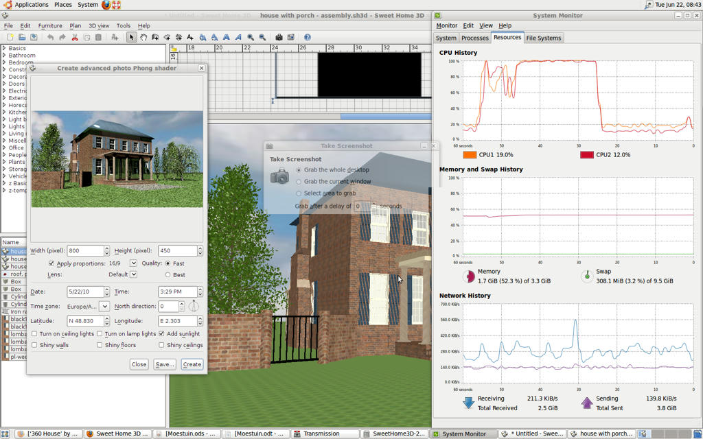

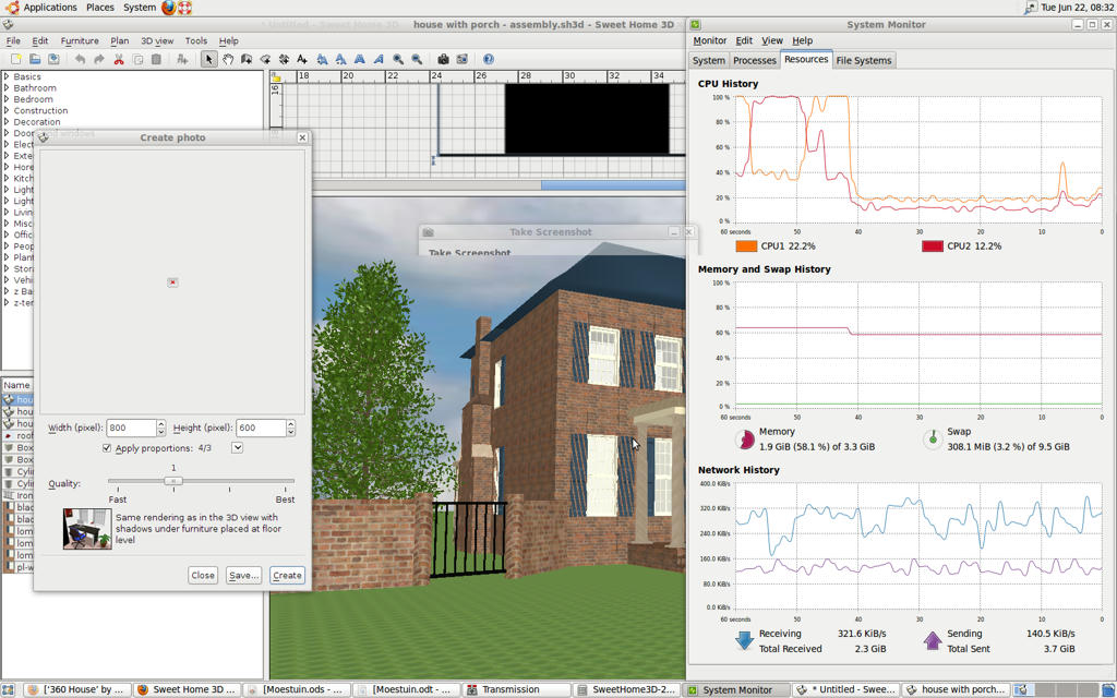

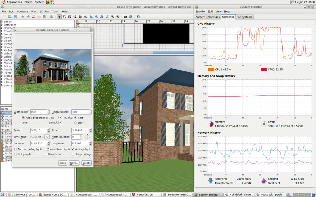

Emmanuel:

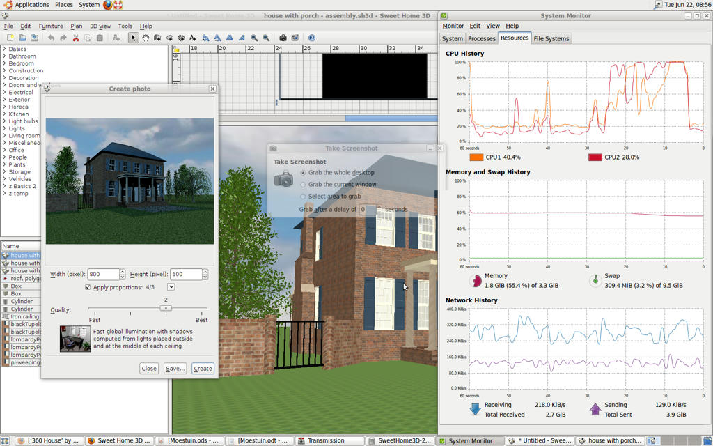

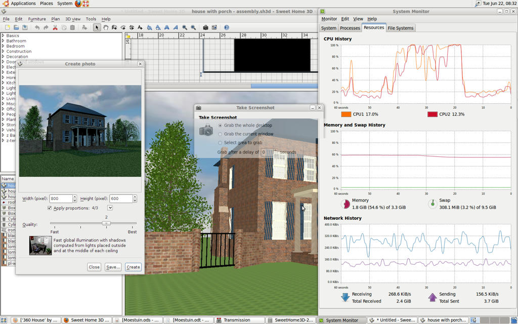

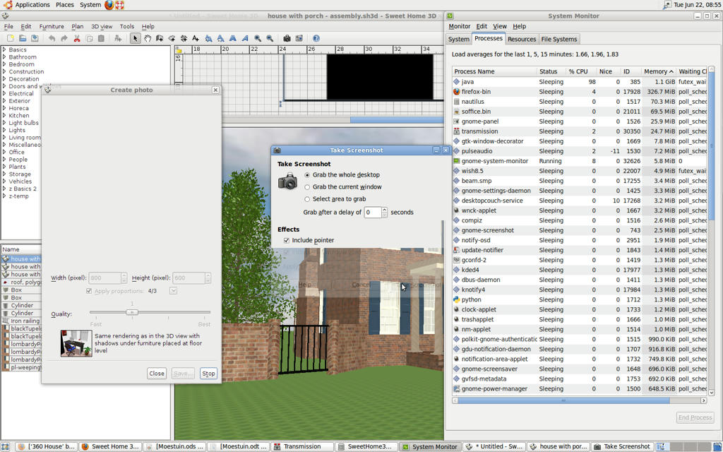

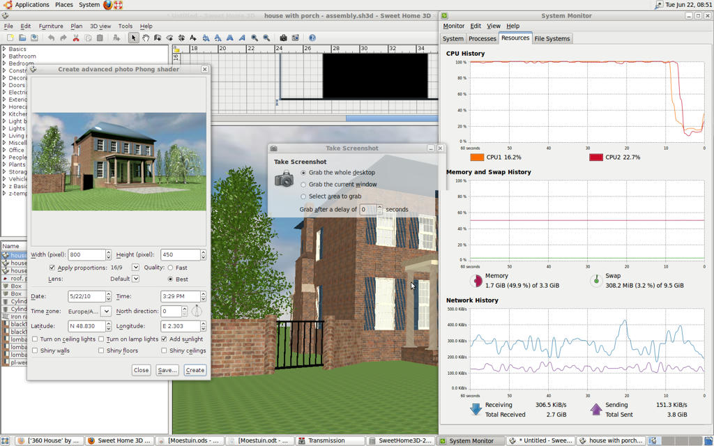

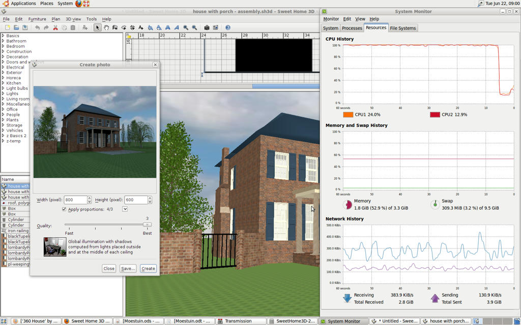

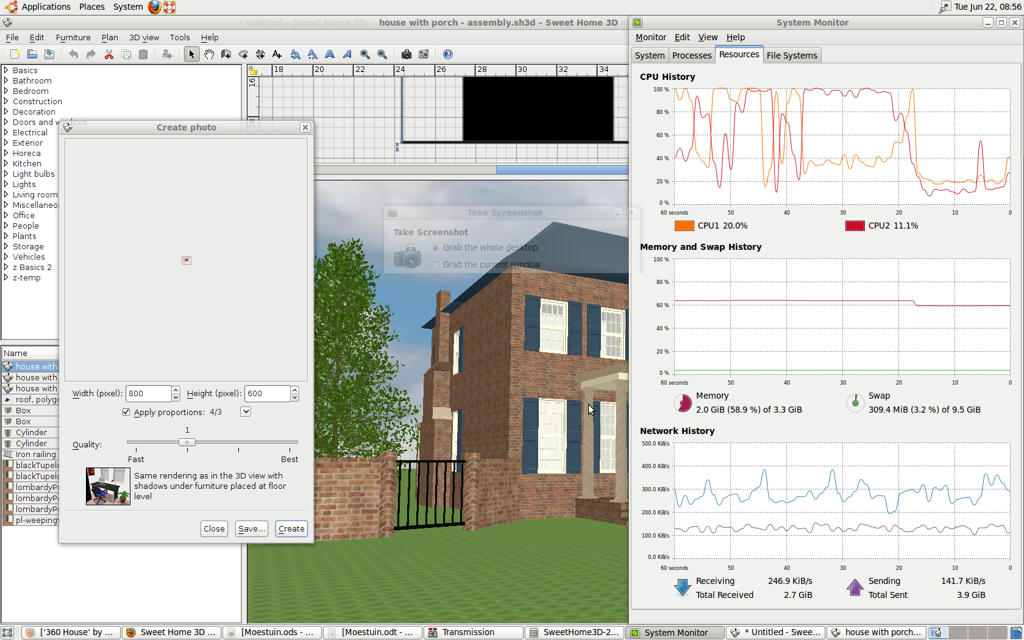

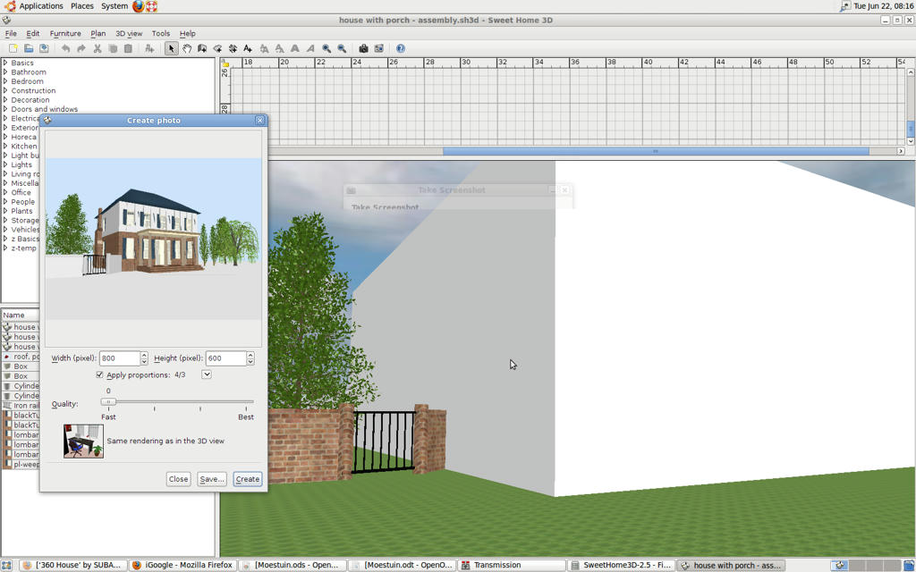

Having installed version 2.5, I thought I should revisit my "house with hole in the roof" that started this thread. I made a series of renderings which showed a few surprising things. Because I wanted to know how SH3D deals with memory, I decided to have my System Monitor open, so I could keep an eye on processor use and memory use.
Here follow a few observations:
- When making a render using Create photo quality 0 or 1, I noticed that the processor load isn't balanced. One processor runs at (close to) 100% while the other "idles" at around 50%. This goes back and forth between the two processor cores. In quality 2 and 3, and in the Advanced Photo and Phong renderings, both cores (after an initial uneven phase) operate continuously at near 100% loads.
- Even though I used "XMX 2048" to allow SH3D 2Gb of memory, under "normal" rendering the program only uses between 650 and 725 Mb. That includes the advanced modes. The surprise was the "old" photo rendering in quality setting 1. With unbalanced loads, memory use shot up to slightly above 1.1 Gb. Even so, after several minutes of calculating, SH3D ended the rendering with a nice red cross in the window, but no image.
- SH3D keeps crashing on opening files. I have reported this before, but this behaviour hasn't changed. As I described before, the solution is to open SH3D, insert a model (any model), and then open the file on which I want to work. When the file (almost any file) is opened in the second instance of SH3D, there is no problem. So here are a few questions: (1) what parameters change in SH3D when I insert a single model into an empty sheet and (2) why and how does this influence the opening of the second instance of SH3D. All these crashes I keep reporting are not related to textures or other mistakes on my behalf. It happens on most of my models, regardless of what textures have been used. I have used large textures (2048x2048 pixels) many times without problems, and I have the feeling that the bug was introduced somewhere in the last few months. Maybe when the feature of textures on models was introduced?
- I shall reduce my memory setting xmx 2048 to xmx 1024. Maybe that is causing a problem, and seeing that SH3D normally doesn't use more than, say, 750 Mb, it only seems overkill to allow more memory.
I include links to my last error logs. I checked them, but couldn't find the "mesa"and "texture" lines Emmanuel described.
The other links are screenshots of all the renderings I performed. Apart from the rendered image, they show the System Monitor window, where you can see the processor load and memory usage.
- The first screenshot with the "white house" is from the first time I loaded the program. The house is made of 4 imported OBJ's and wouldn't render in the 3D window, although the photo render Q0 shows the house correctly. When I ran the Q1 render, the program took so long that I killed it. That produced the first error log.
- The second error log is from reloading the file. SH3D crashed before it was ready with the 3D render.
- I then opened SH3D and inserted one single object. After doing this, I opened the house again, which now showed correctly. This is what I almost always have to do in order to be able to work on a previously saved file. All the other screenshots were made without SH3D crashing, in one continuous process. They were created in this order: Photo 0, Photo 1, Photo 2, Photo 3, Advanced photo fast, Advanced photo best, Phong fast, Phong best, again Photo 0 (b), again Photo 1 (b, c, d), again Photo 2 (b) and again Photo 3 (b).
I hope you all have a very nice day.
Photo q0
Photo q1
Photo q2
Photo q3
Advanced photo fast
Advanced photo best
Phong fast
Phong best
Photo q0 -b-
Photo q1 -b- halfway
Photo q1 -c- memory usage
Photo q1 -d- ready
Photo q2 -b-
Photo q3 -b-

Indeed, my Ubuntu PC is the one I use most frequently. I like the interface and stability, as well as the fact that this machine has better specs than my Windows Vista laptop.
My Ubuntu install is "clean" in the sense that I haven't changed anything. I am not a PC technician. So nothing is overclocked or so. And no, it's not a dual boot machine, because I don't have a legal copy of Windows lying around, and wouldn't know how to do a dual-install when already having Ubuntu. Windows isn't really facilitating dual-installs, as is Ubuntu.
I could repeat these same tests on my laptop, and probably will do so shortly and report on my findings.
I'm not sure if you have studied all the screenshots I included in my previous post. Those may provide a clue to the answer: (a) the increased memory use during quality setting 1, and (b) the fact that it doesn't complete and (c) the erratic processor load swings. Also the fact that my problems disappear when I first open another instance of SH3D with ONE item in it, makes me rather sure that it's not my Ubuntu PC but some bug in SH3D that causes these crashes.

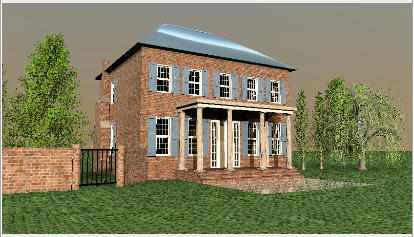

Yay, well done Emmanuel! smile smile smile
Previously using Sweet Home 2.4 Uber shader 1.3
Now with Sweet Home 2.5, Create advanced photo... 1.5
Also as a direct comparison to the first image, Sweet Home 2.5, Create advanced photo Uber shader 1.4 (1.5 isn't available yet) the roof renders correctly.
For anyone else reading this. Don't worry about the silver leaves (as seen on the first and final Uber render) the Uber shader is work in progress and holds lots of advanced possibilities for the future.
No need to call the builders to fix the roof anymore! smile

db4tech:
Thanks for you offer to render the picture for me. The problem isn't so much in the rendering, as well in the fact that I have to start a new drawing first, before I can open a file.
The rendering works fine, except for the one low quality setting. Even the leaking roof which started this thread has been fixed in v2.5, as you demonstrated so clearly, and which made me come back to that specific model.
[Jun 22, 2010, 2:04:45 PM] Show Printable Version of Post    View Member Profile    Send Private Message [Link] Report threatening or abusive post: please login first  Go to top
Post Count: 4005
Re: Imperfect rendering
Emmanuel. db4tech:
A few moments ago, I tried to make a standard photo render with quality setting 1 of the "House with porch" as shown above, using SH3D v2.5 on my Windows Vista laptop.
Unfortunately the results are the same as under Ubuntu: no image.
Q0, Q2 and Q3 render the picture as it should be, without the leaking roof. I'll see if I can install the additional plug-ins and do the the other renders as well.
