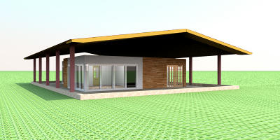

Doing some renderings I found that in this file the horizon is visible through the house. Walls are set a zero transparency.
If the image is too small, there is also a link to the original 1.8 Mb picture .
[May 23, 2010, 2:34:30 PM] Show Printable Version of Post    View Member Profile    Send Private Message [Link] Report threatening or abusive post: please login first  Go to top
Re: Auto-crashing file
Hum... Maybe it's the reflect of the horizon on the wall? wink
[May 23, 2010, 2:47:24 PM] Show Printable Version of Post    View Member Profile    Send Private Message [Link] Report threatening or abusive post: please login first  Go to top
