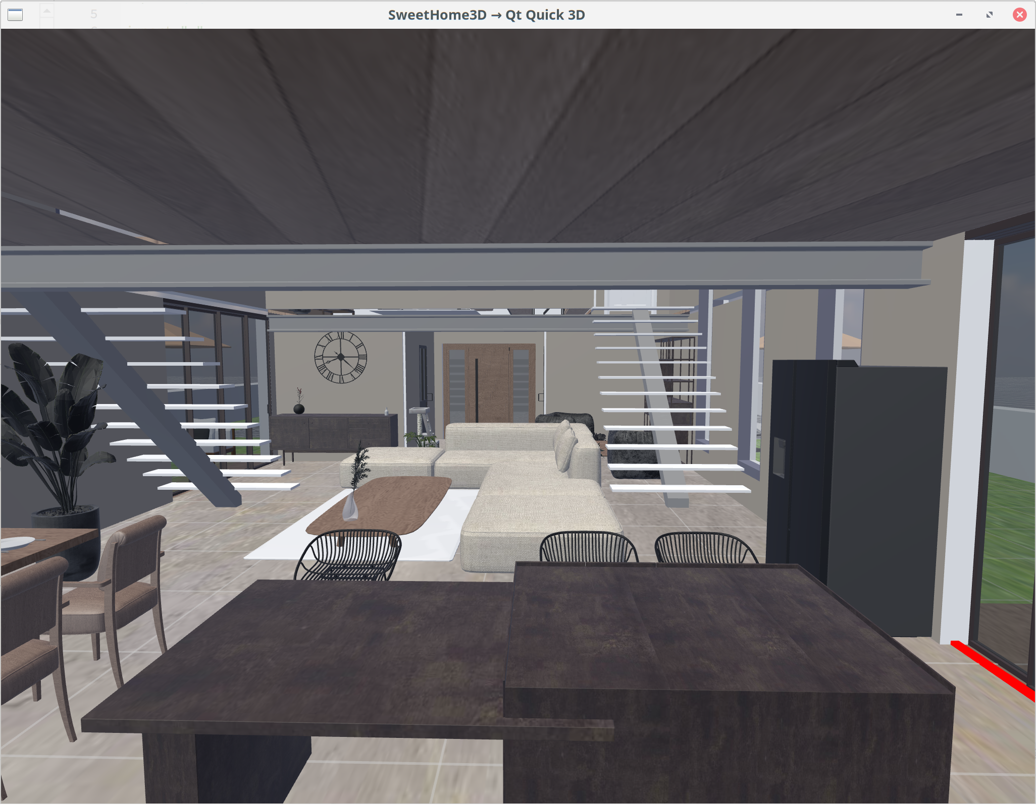

Here's a little screenshot, from one of SH3D examples:
Note that the transparency of materials is currently not being correctly imported by QtQuick3D. I fixed the bug in Qt 6.11, but it will only be included in their next release. It was also backported to Qt LTS 6.8.
There are limitations in QtQuick3D regarding the number of lights that can be included in the rendered scene (max 8 for my GPU), I'm not sure yet how to overcome this limitation. QtQuick3D is mainly designed for dynamic scenes, whereas I'll only be rendering static objects, so there might be a way to work around the limitation (shadow pre-rendering or something like that).

Something humorous that I notice in both the above screenshot and Gaudi's video is that the honking big beam appears to be supporting the above wall using a cushion of air. laughing I'm guessing this is one of those bugs Tofeee is talking about, because it's not there when viewing the file in SH3D.

Yes, I also remarked that in that example, the floor of that room isn't rendered correctly...
It's probably just a normal orientation issue, I'll fix that.
One other major thing I still don't support is the inclined wall; it will come a bit later when I have time to adjust the wall rendering.
Apart from that I've looked into the lights rendering and... generating a pre-rendered lightmap is quite CPU comsuming ! It makes sense as it is basically a ray casting for the whole scene, but still. And Qt6 fails to generate it for some of the furnitures (missing UV map or something like that), I'll have to check what can be done.
