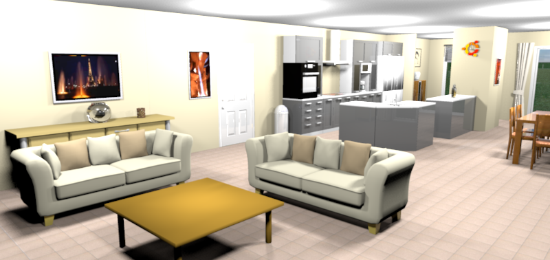

Here is the room with a flat ceiling (I am modelling with sloping ceilings presently): wink Thanks Hans,
I managed to get a visualisation by using box and triangle shapes coloured black to represent the windows.
I have been working on modelling the interior of the main living area in my house (where a large wall is soon to be removed). The results of the Sweet Homes product have been very good.

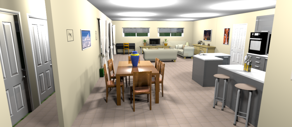

And here is the view from the other end of the room.
Attachment room1.png (580151 bytes) (Download count: 3941643)

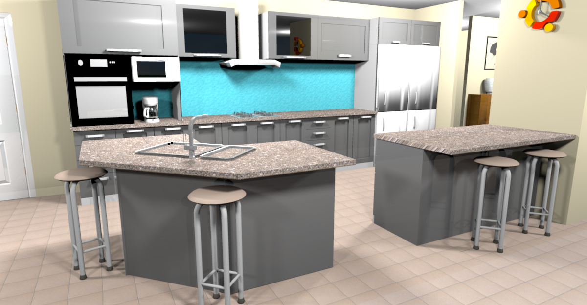

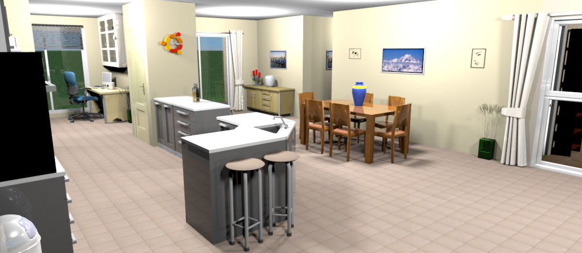

I have also been experimenting with resizing cabinets etc to create a kitchen layout.
This has already led to my wife changing her mind on some design points!! In the picture below, I used a mirror as the glass splash-back and changed to texture to a water droplet that I downloaded.
Attachment new kitchen1.png (976863 bytes) (Download count: 988479)

By the way, in the kitchen model above, I used a box with th marble texture form the library afor the benches.

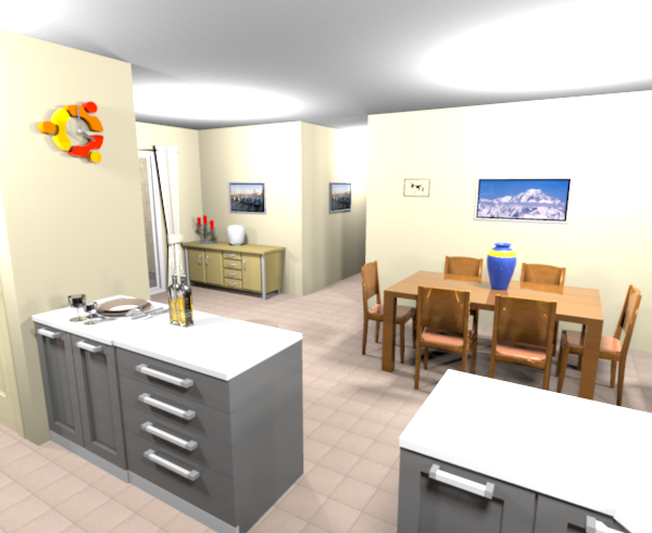

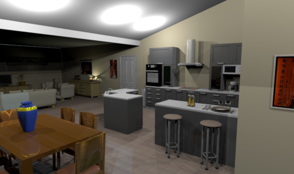

In the pics below, you will see that the light on the celilng does not activate one the celiing is sloped. In the seceond picture, there are light sources attached (randomely at the moment!) to the sloped ceiling to light the floor area below. These light sources were lifted out of a light test room linked on one of the forums. (I think Hans drew the test room?)
The luminosity is lower than the standard ceiling light (I experminetd with sizing the light - made no change - but I will place multiple lights to mimic the actual room lighting scheme.
In the pics below, I have used a box to replicate the beam that wil be placed where there is presently a wall.
As you can see - I am enjoying using the software! Well done to the developers!

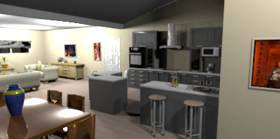

Attachment floor.png (114814 bytes) (Download count: 70299) (In the second pic, I used the advanced render tool (very nice Emmanuel!) to turn off the ceiling lights and activate 'lamps'. I have also installed the advanced render 1.2 and am experimenting with the sunlight positions.)
Attachment floor2.png (245538 bytes) (Download count: 72152) (In the second pic, I used the advanced render tool (very nice Emmanuel!) to turn off the ceiling lights and activate 'lamps'. I have also installed the advanced render 1.2 and am experimenting with the sunlight positions.)
