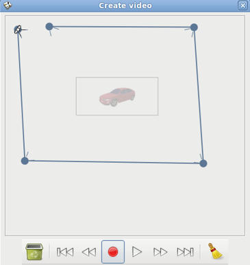

How can I creat video ?
Hi dears,
I have virison 2.3 , windowes " vista "
when I creat video ,,, the recorder only from start point and end point ...betwen these points it does not recrod ....
I need some help!please ,
Thanks, Sara

When you make a video, the red record button is not a start-stop button that you only push at the start and end of your video walk.
You have to place the virtual visitor and push the record button for every point that determines a key-point in your walk-through. Imagine that you want to make a walk in the form of a square. You will then have to click the record button four times for every corner of the square.
In the video window every key-point will be shown with a big blue dot.

Hans ,
Thank you ,,
It is work very good now .....
