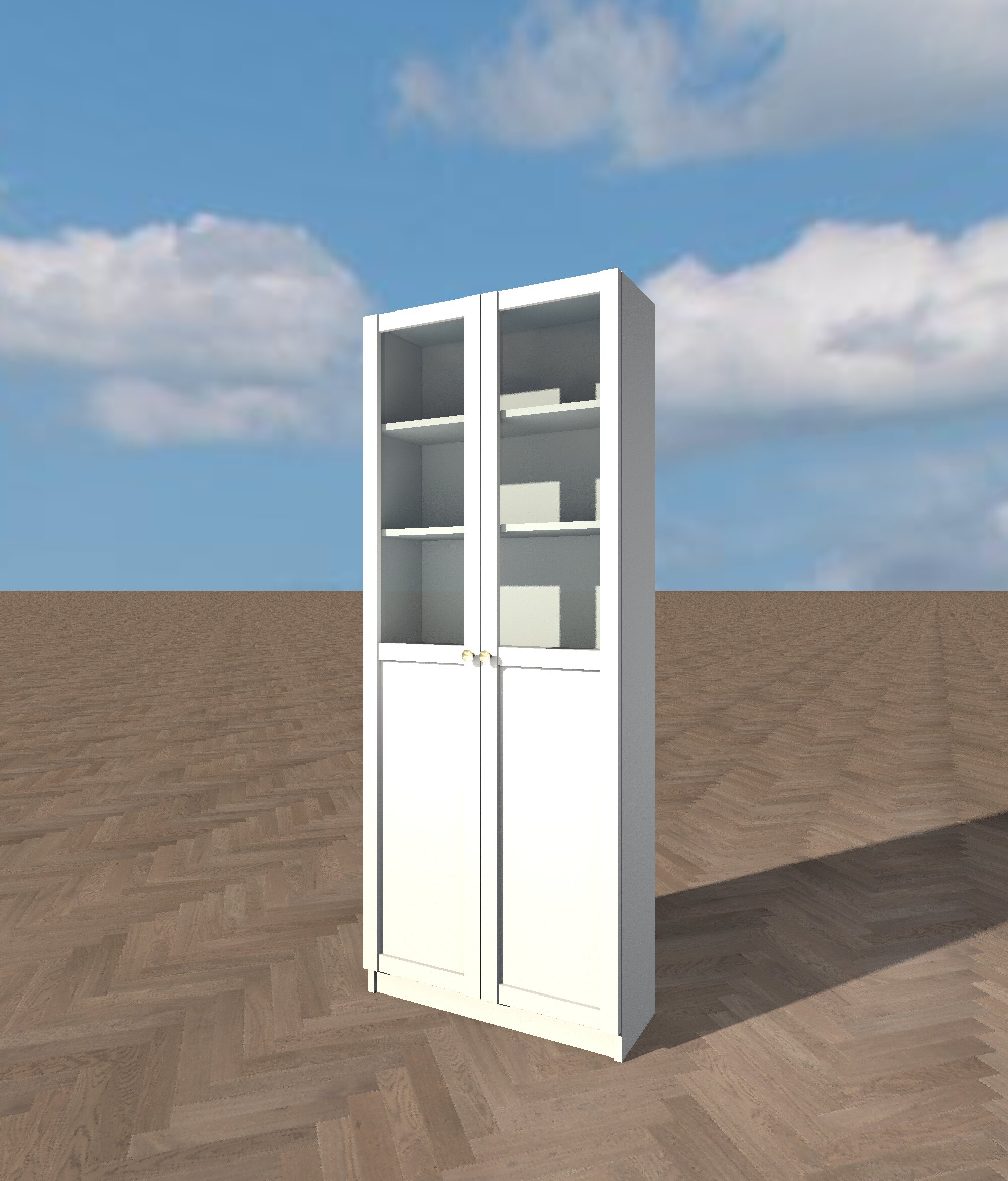

That is the one main disadvantage of the models created with AI: the result is a single object with a single texture. There is little to nothing you can do to change it. You can't add deformations to open the doors and you can't change the color/texture of individual parts.
But, the AI gives very accurate results and does it very fast!
I see two possible solutions you can try:
1. Edit out the handles from the initial picture with an image editor before running it through the AI. If the AI doesn't add handles your problem is solved. You can run a gold handle through the AI and then add the resulting object to the the generated cabinet object for each missing handle. Export them together and import again to get a single cabinet object with your gold handles.
2. Generate the cabinet picture as is and remove the handles with Blender. You only have to flatten a few faces to remove the most of the original handles. Then add the AI generated gold handles. The gold handles should display over the texture part of the original handles. You can also try this option if the AI insists on generating a cabinet with handles.
Your best hope is option 1. With option 2 there is a possibility that the cabinet texture distorts a little where you removed the original handles.

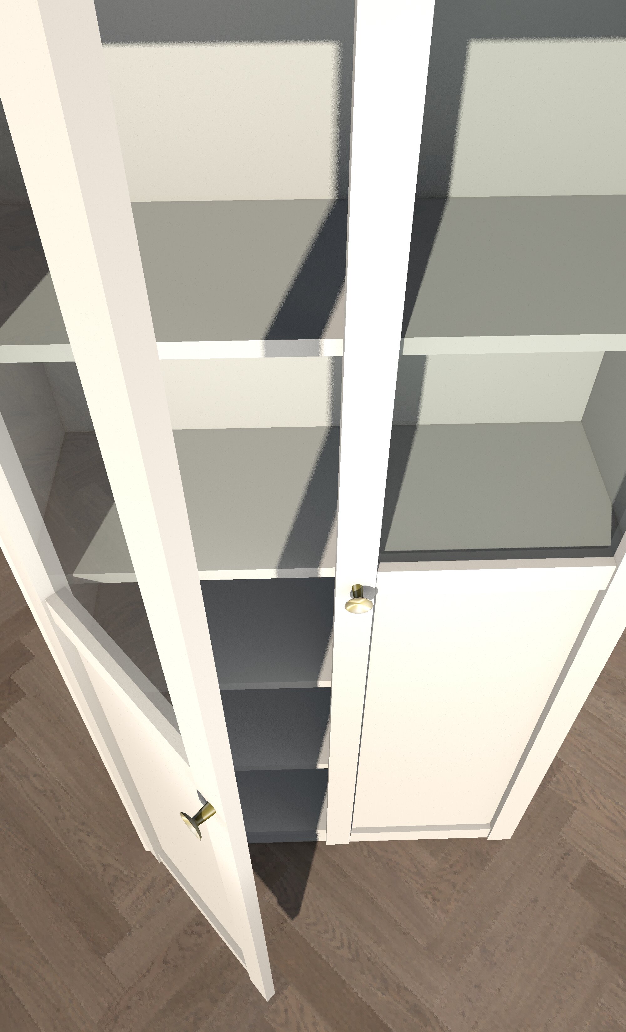

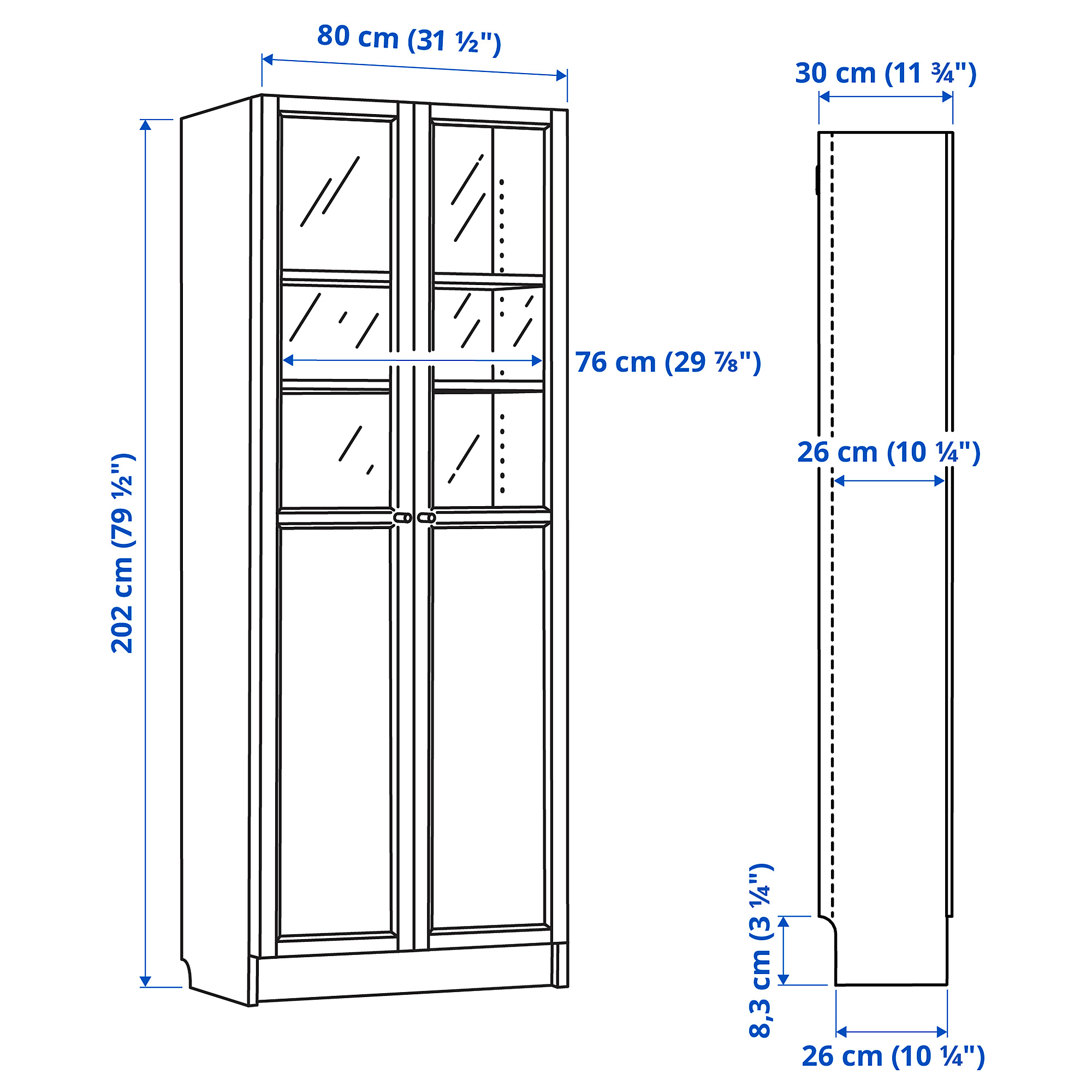

Hi! I want to say that AI is not an ideal tool at all today. He is also often naughty and does not want to do high-quality work. For example, my closet turned out to be completely uneven, shelves with a bend, one glass sash with a tilt and opaque. You can't idealize a stupid car here. It's better to do everything yourself. Everything that consists of rectangular elements can be made independently in SH3D. This closet, too. First you need to study the drawing of this cabinet. And make all the details from the boxes, according to the dimensions of the drawing. It will take some time, but in the end you will get a magnificent wardrobe without flaws. I made the glass out of a box and then exported it in OBJ format. In the MTL file, I added D 0.2 to all 6 groups, saved this file, and returned the modified model back to SH3D. Glued the glass to the door. I managed to make a pen with Trellis on the second attempt, the first attempt was completely unsuccessful and the AI gave me a shell of three bowls. It is necessary to treat his failures philosophically. So far, it's a stupid machine that often makes mistakes. You need to repeat it and you will get the desired result. It won't be long before this stupid car becomes a terrible unmistakable monster. There's still time to smile. And do everything yourself as soon as possible. Learn and gain mastery without AI.
File Ikea Oxberg
Keet, but there is a problem. If you add a pen made by AI to the model from the boxes and export-import it back, then SH3D refuses to return it as a model (although it is an OBJ). Can't read this format. I couldn't figure out what the problem was. That's what Captaincook was talking about.

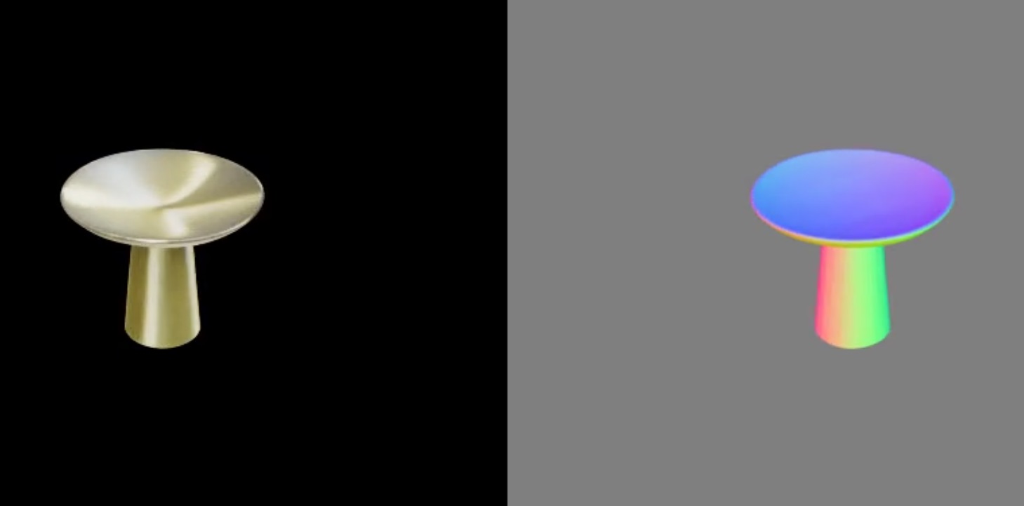

furniture handle model

I'll tell you everything in order. First, I created a pen model based on a photo in GDB format, then converted it to DAE format. If I converted to OBJ format right away, then I had problems with the original single texture that was in GLB. This ZIP with DAE inside opens perfectly in SH3D, you just need to move the gloss slider a little bit in the texture setting, just a little bit, the texture immediately appears. Now, if I export this model from the SH3D scene as an OBJ, then this OBJ model and MTL appear on my computer. But she can't go back, SH3D won't let her in, refuses. I thought the reason might be DAE, but I couldn't convert GRB to OBJ, they were all the same color. So I settled on DAE. confused
