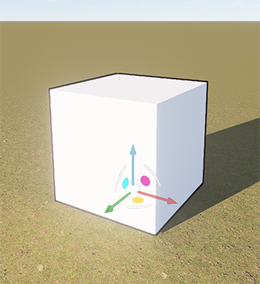

Yes in this case it would help. But that's not the point I was making. In order for it to work automatically in SH3D, a code should be written, which I don't think is very simple. I meant the graphical display of options that are already implemented (rotate, move, copy) are just shown as they are. In all other 3D programs, manipulation is represented by a coordinate system with the addition of rotation and scaling, with the addition of some other keys on the keyboard depending on what you want to do.
I can't see major differences between "other" and the current one:
3. If you want a customized pivot point, you will first need to define the 3 coordinates of this point and then set the rotations to it.
If you're thinking of just setting it with the mouse or your fingers, forget it. This is not a professional approach for someone who wants at least some precision.
4. If you don't like to use plugins (ok) BUT don't suggest to unnecessarily complicate the main program.
