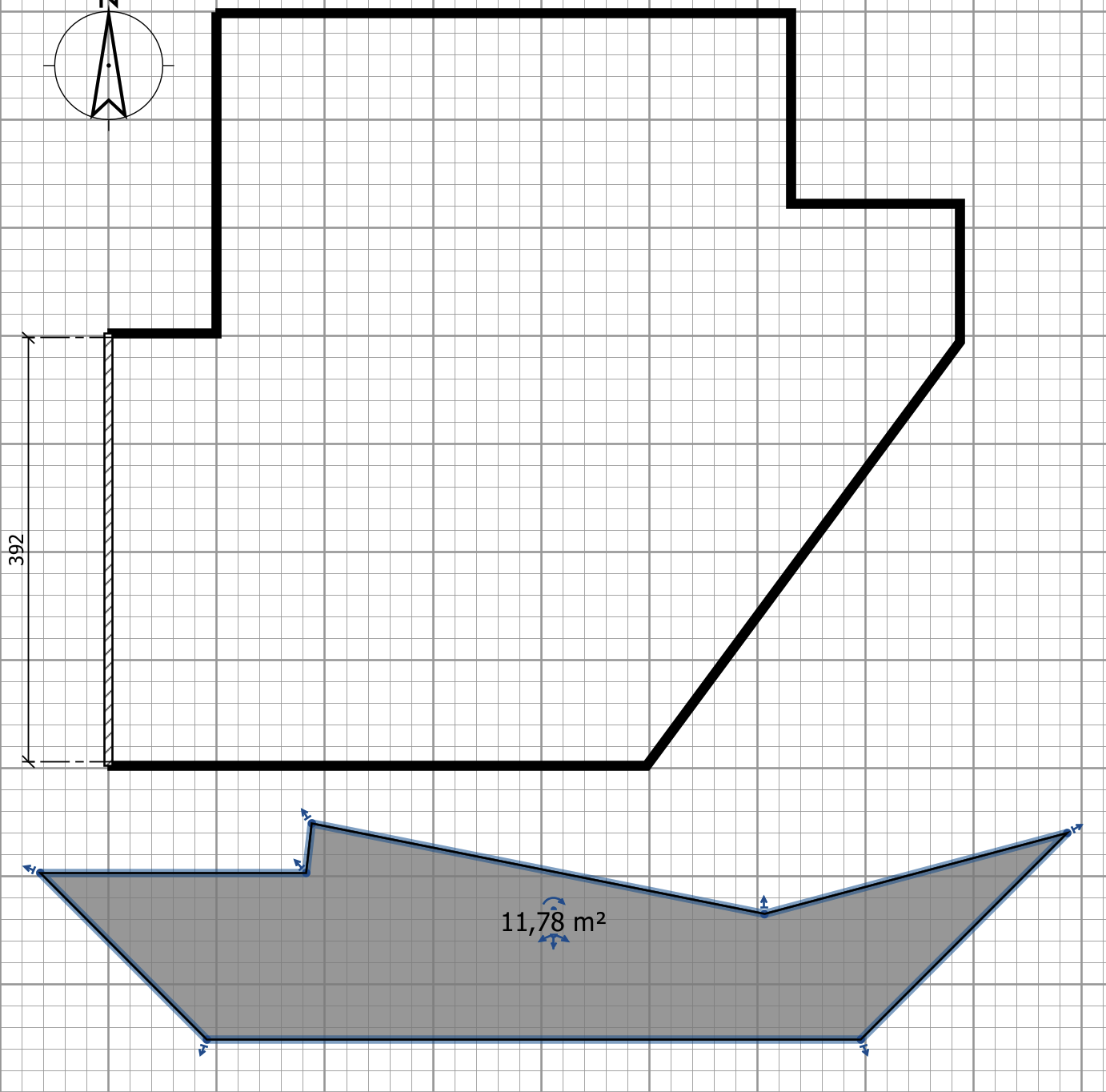

when you create rooms, you can have their area displayed.
see below in the screenshot:

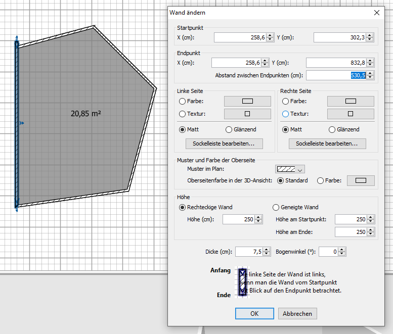

In the following screenshot you can see that area can also be displayed in the mode with walls, but how?

Re: How to show area between walls ?
but how?
Creating a room!
After you create a closed space with walls (preferably connected),
select room tool from tools bar and
double click inside the space formed by walls.
A new room with their surface will appear.
[Apr 23, 2024, 3:35:20 PM] Show Printable Version of Post    View Member Profile    Send Private Message [Link] Report threatening or abusive post: please login first  Go to top
Keet
Post Count: 1366
I suspect that you are trying to find where the area display is switched on/off in the modify walls dialog but the room is a separate object with its own modify dialog. Double click on the room and you get the modify room dialog. At the top right you see a checkbox where you can switch the display for the area on and off.
