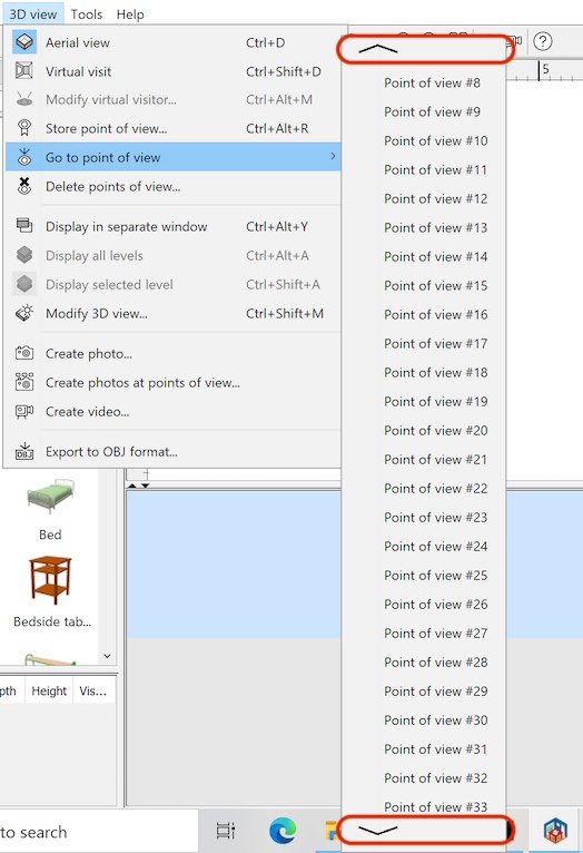

Here's the first public Beta version of Sweet Home 3D 7.3.
This new version contains some bug fixes that I would be happy that you test when possible:
- I added up and down arrows to scroll the Go to point of view menu when it's too long on small screens. Just place the mouse pointer on these arrows to scroll the menu.
