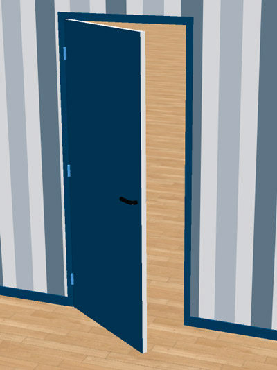

Hello I am looking for an interior door (if possible that can be opened) with 2 sides of different color / texture

Several options:
• Create your own door
• If you're lucky the door you like exports with separated groups. This would make separating front and back a lot easier. See the How-To listed below.
• If you're not that lucky you need something like Blender to separate the front and back materials.
This thread explains how to add deformations (opening the door)
Here is a How-To to change material names:
https://dodecagon.nl/Docs/ChangeMaterialNames/Change_Material_Names.pdf
https://dodecagon.nl/Docs/ChangeMaterialNames/Change_Material_Names_files.zip

Re: Door with two different sides
The catalog proposes a front door with materials different for its two sides, but you’re right there’s no interior door with similar ability.
I could create one based on an existing model. Which one in the library would you prefer it looks like?

If you could create one based on the classic "door" by eTeks it will be perfect
You'll find the door in the library DoorWithTwoSides.sh3f.
Hope it has enough materials to create the arrangement you want to achieve.

Oh oh! Thank you Emmanuel, most useful!

@ Puybaret
Wahooo ! thank you it is exactly what i was looking for ! applause
I will definitely use it very often.
Everything is perfect, thank you again for your help biggrin
