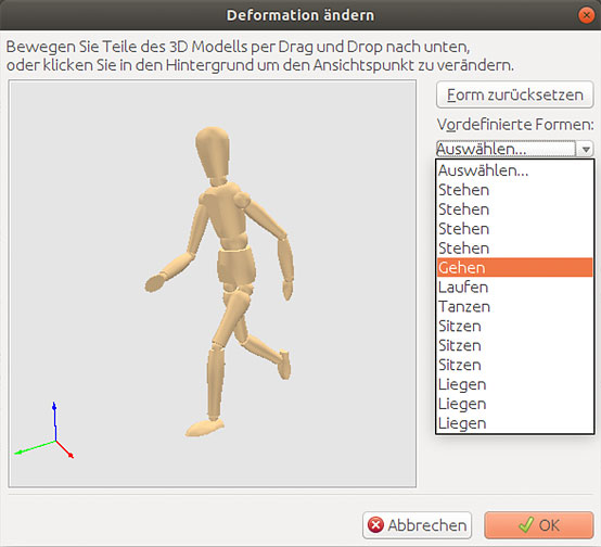

German contributors weren't available this time too, therefore I translated the new words myself and with the help of web translation tools, I hope the translation is quite accurate (I studied German during 5 years at school and that should help to avoid main grammar faults). I have mostly some doubts about how to present the list of postures. At the moment, I used verbs as shown in the following image but I'm not sure it's correct. What do you think?
