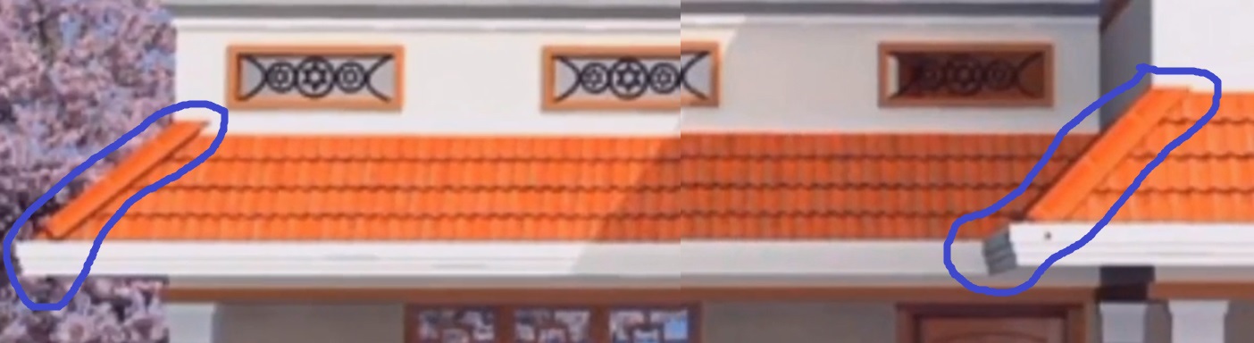

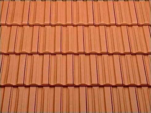

Hello.. In the past one month I have learnt a lot on home building and I have successfully built one. However, over the weekend I tried to put a sloping roof to my house but I was unable to do so. I am posting a picture of the sloping roof how I want it and request members of this forum if anyone can help me with it.
Here is a google drive link to my house with the below two roof tile patterns
Here is the style which I am looking at
Please help
Thank you

You will either have to find an object representing a roof tile or try to create it your self. You might have to settle for a roof tile that just resembles the displayed tile.
When you have the tile, tilt it to the correct angle and start copy-pasting lost of tiles in rows with different elevations. Just create a row, group it, copy the row, increase it's elevation, and position against the previous row.
Sometimes manufacturers have object files for their products you can download but it's a slim chance.
You can also cheat by creating a texture from the photo and apply that texture to a shape you create.
It's easy to create the border at the bottom of the roof with resized boxes.

Made something in Blender, hoop this helps!

Wow, that looks really good. Exactly what kawal needs to create his roof!

It is indeed very beautiful... exactly how I wanted it. However, I am still struggling to put it in place especially the corners. Thank you so very much for the model.
I tried the cheat you suggested but being a newbie, its becoming a little tough for me. Tilt and elevation in a sloping angle is where I am struggling. Unable to figure out how to have proper corners as marked in the image below.
May I ask some further help? I have linked google drive link of my sh3d file in the first post.
Thank you.

Shape coordinates for the corner
I'm sure Kevin can create a much better corner with Blender like he did with the roof tile but it's a weird shape so this is what I could do with the Sweethome3D Create Shape tool.

omg! lots of groupings... i need to understand your solution properly before I make it for the whole house. Thank you very much for the push ... i was also trying another way of getting this done by creating a shape... like how you suggested earlier. Will try both.
what you made is close to the actual shape... wondering what is the mathematics behind calculating the coordinates. If Kevin can make one, it would be better.

If I had so dimensions indications I could make something in Blender, for me it seems to be a U-form piece, kind of tube cut in halve, right?
In my last post I provided links with what I made. That includes a .sh3d file with the object of the corner. It's a shape created with the Shape tool, copied, the copy mirrored and rotated, and then the two parts attached to each other. So it's a weird shaped corner.
There's also a screenshot with the dimensions I used for the corner object. Maybe import the shape objects from the .sh3d file in Blender and go from there. A little thinner with smoother edges.

Ok, done, I made it big enough you could resize it if needed, also added Blender file in case you want to reshape it, Blender it's free and very easy to use to modify shapes.
