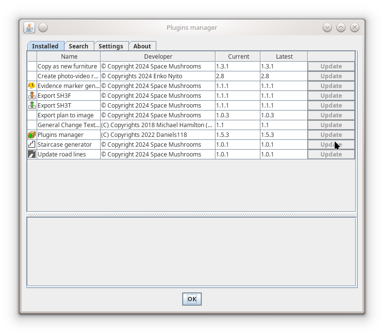

dorin
Romania
Joined: Apr 24, 2014
Post Count: 683
Re: Plugins manager
I tried it on a fresh SH3D 7.5 installation under Linux.
Plugin manager plugin was successfully installed by opening it with SH3D.
After rebooting I tried to install, one by one each plugin.
They were installed:
All the rest give:
[May 20, 2025, 8:24:41 AM] Show Printable Version of Post    View Member Profile    Send Private Message [Link] Report threatening or abusive post: please login first  Go to top
