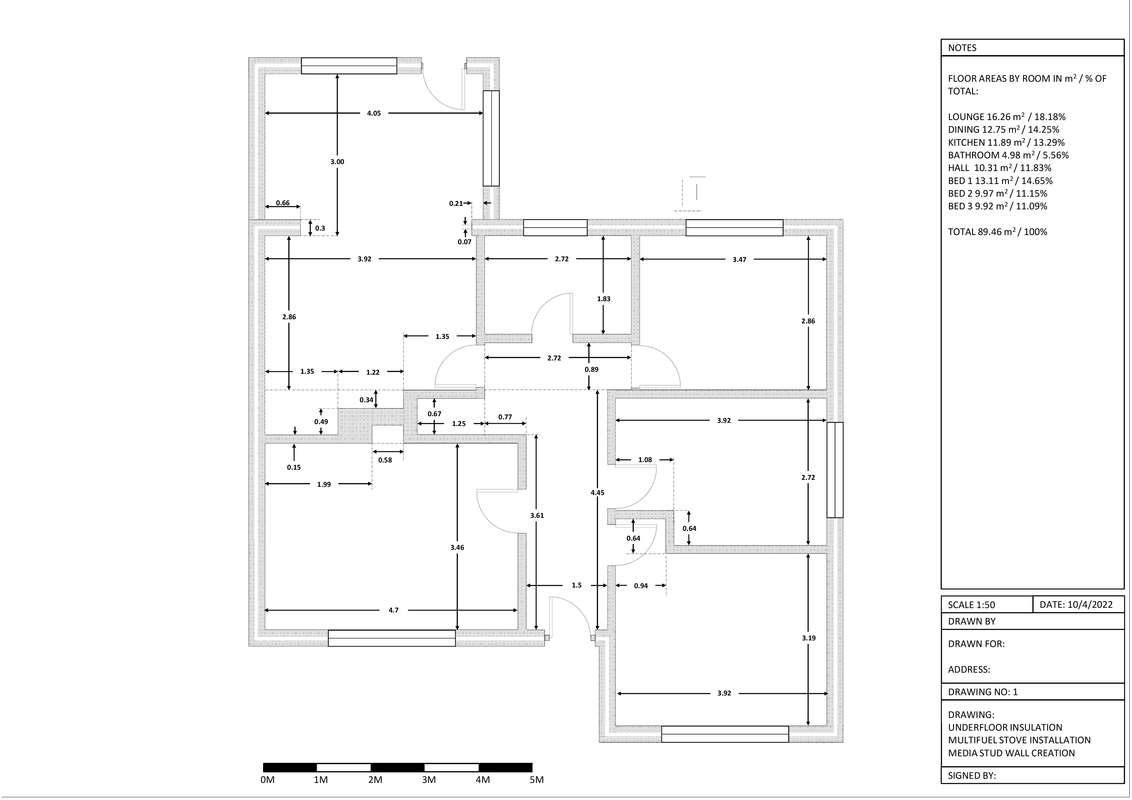

I wasn't insulting the end result, more pointing out that it will be painful. A simple example... In Excel you have all your drawn elements on the top of the spreadsheet as just one big collection of drawn objects.
My previous Excel elevation has several "groups". Unsophisticated but perfectly straightforward to achieve, relatively, useful results relatively quickly. The previous image gable wall elevation darker brick portion being built from a single (rectangular) brick/copied twice / both selected / copied twice etc to form a single course. The course grouped / copied x 10. This copied x 2 and a wall is constructed in a minute or two. Layer management (of these groups) is also unsophisticated via Excel "send to front/send forward/send to back/send backward" but for a, relatively, small number of layers it is fairly straightforward to manage (while the "select objects" menu item and a little VBA permits identification of hidden objects in a straightforward fashion also).
By the way, if you draw on a worksheet and print - the output scale is distorted. You must print from a chartsheet to maintain that not to mention that a print size must be chosen before the dimension property of the chartsheet can be set to the desired size (A3/A2 etc)
It is a lot of overhead compared to Sweet Home 3D but familiarity, of course, breeds speed
Your screenshot looks good
Cheers smile
then Excels abilities as a technical drawing tool.
I haven't looked into it in any detail but it seems that VBA can be used to produce relatively sophisticated results (see commercial "Excel Draw" for example)
Getting them all onto a standard A2 at proper 1:50 scale with a proper info block is a lot more work and requires other software.
This is an Excel A3 chartsheet draft pdf used as the basis for a building notice application a few months ago - I hope you like that too?
https://i.postimg.cc/DyQmHwZ4/A3-Excel.png
