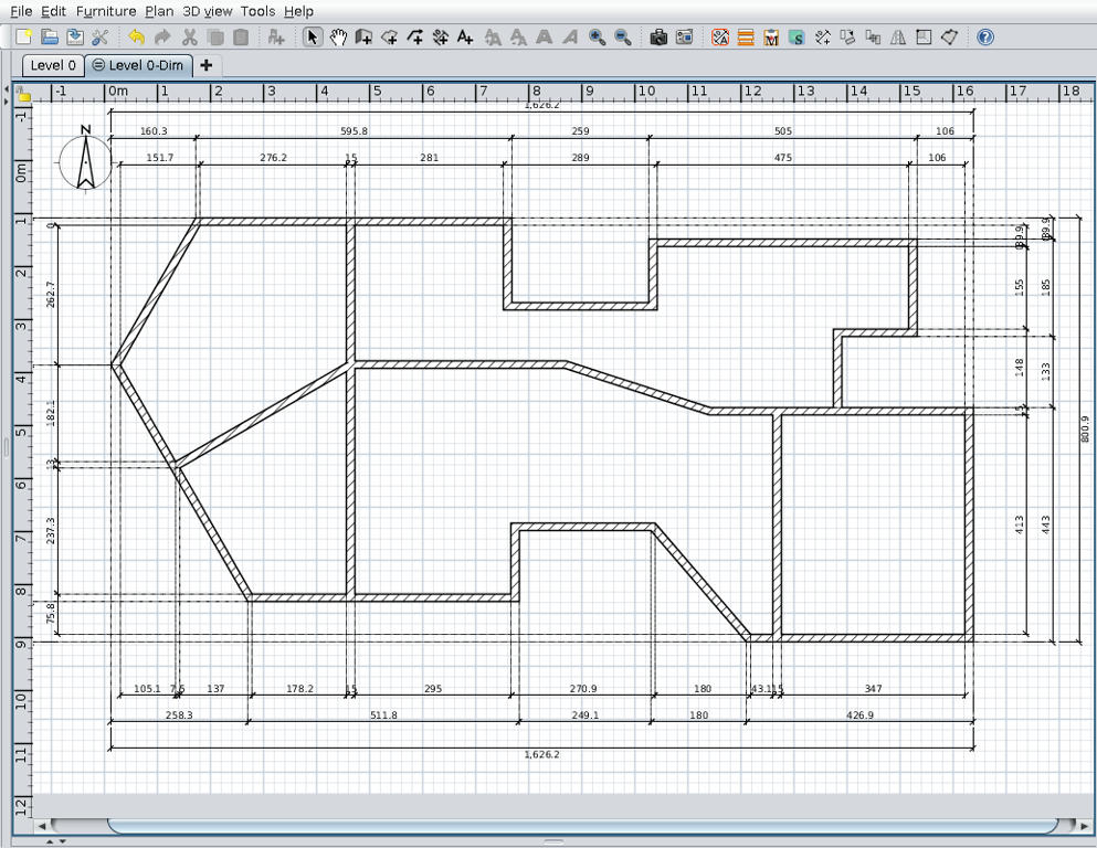

New version 1.3
-add complete surrounding dimensions
Also on Source Forge

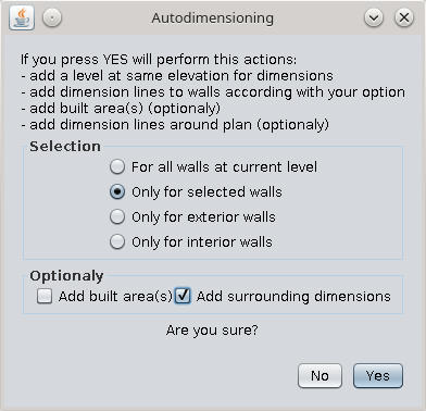

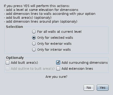

New version 1.4
-add option to draw outline around built area
-add option to draw extension lines for surrounding dimensions
(An coworker, architect, have told me is not allowed the extension lines in our official plans.
I'm not totally agree with that so I make it optionally)

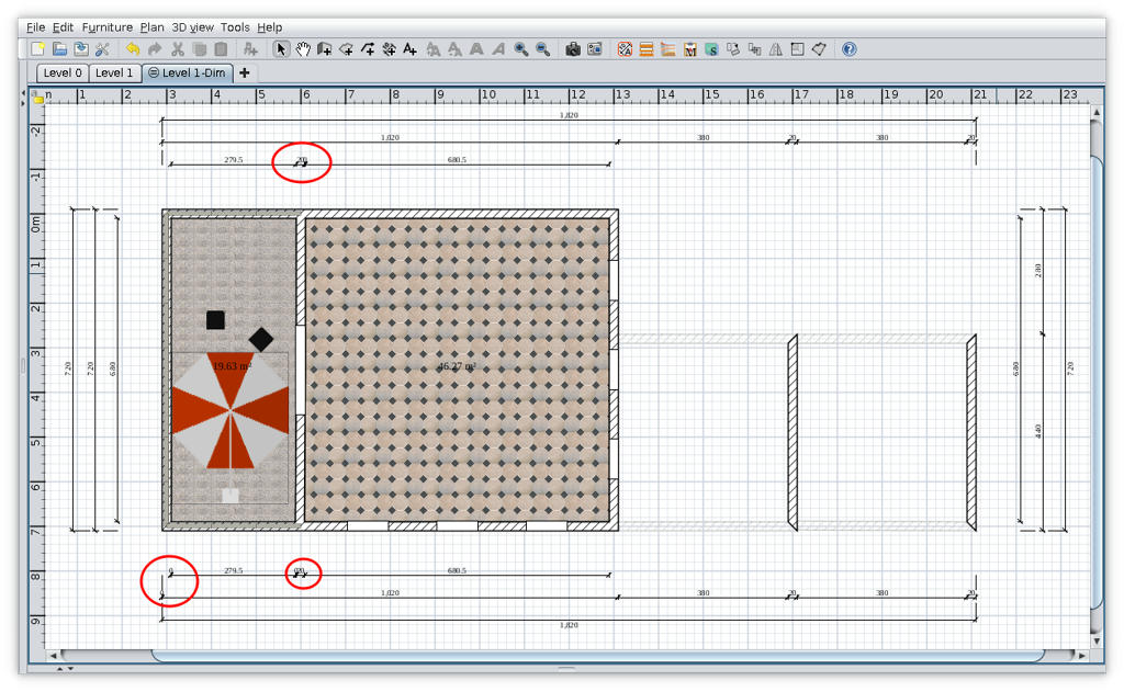

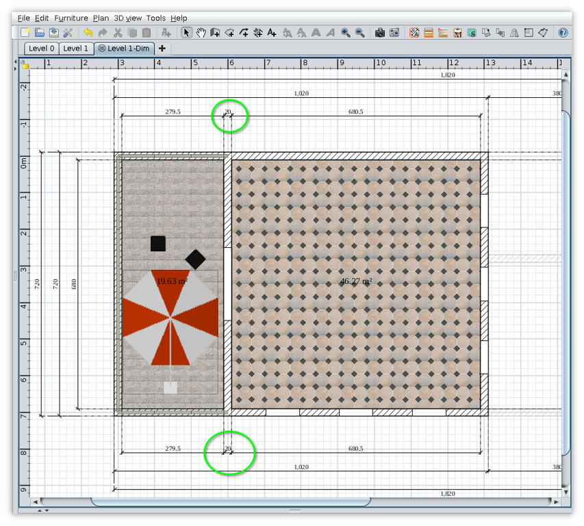

1. The plugin
2. Some observations
Sometime on some plans appear zero dimensions (like what I mark with red in above image).
I've try to avoid this without success unless I reduce drastically the precision.
My conclusion was that zero dimensions appear when a wall(s) are not perfect horizontal or vertical especially when are splinted.
My workaround is this:
- identify the walls and click undo to delete the Dim level;
- correct the walls by clicking on their end points (magnetism enabled)
- try again to add surrounding dimensions
Maybe will not succeed from first attempt and you have to try again.

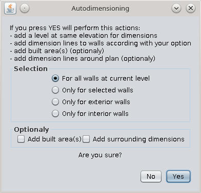

Re: Auto Dimensioning plugin
Thanks for this update.
There's still something I don't understand: using the 1st demo of Sweet Home 3D, I tried to generate dimensions with the default option "For all walls at current level", but just got an empty level. Wondering if you took into account the existing dimension lines, I deleted the existing ones in the demo, but didn't get a better result.
Do I miss something? It would be nice if the default option would generate something, wouldn't it?
