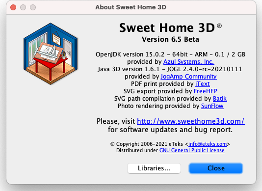

To be able to better follow users' configuration, the About dialog box now shows the provider of the Java and Java 3D versions used by Sweet Home 3D.
The previous screenshot also shows the Java version bundled with the macOS version was updated to Zulu OpenJDK 15 to be able to run under the new Mac ARM Silicon computers. The macOS version was also notarized to be able to launch more simply.
