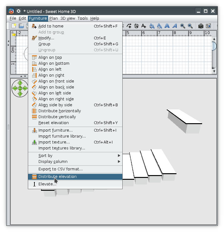

This one are Distribute Elevation plugin v1 .
Is accessible under Furniture->Distribute elevation or an icon on toolbar.

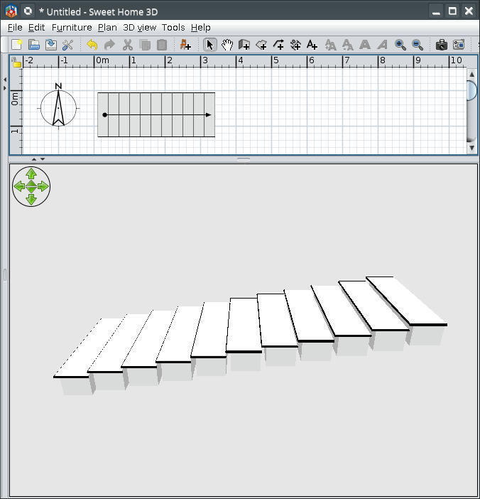

Let say we have some stairs...
but is not quite what we want;

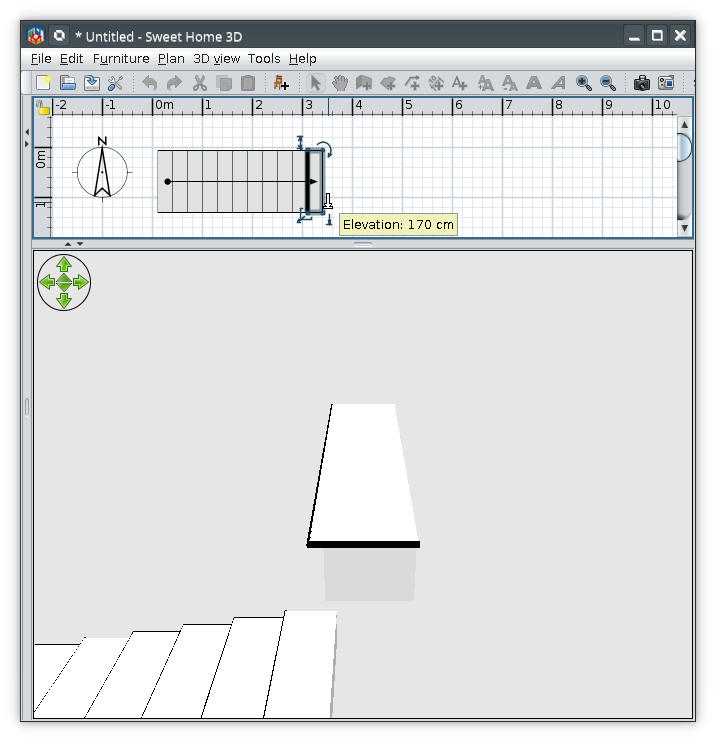

we know the maxim high and don't want to make more precise calculations so:
-select and elevate the last step to maximum high...

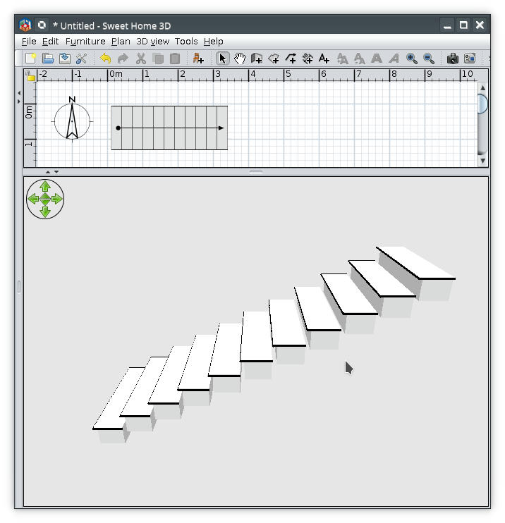

-select all stair steps and:
-this could be the result.
Are more close to what we call staircase.
