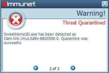

After installing version 6.4.2 under Windows 10, Immunet gave me a virus warning. See screenshot.
Puybaret thinks it's a false positive, but maybe other users get the same message?
Problem is that I can't run this version, so I had to re-install version 6.4. Unfortunately that gives the same problem.
I'm investigating...
UPDATE
I uninstalled Immunet and installed Kaspersky. Problem solved!!

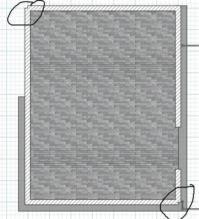

1 ... i am still getting walls disconnecting at corners, but only 2 of them, they are not split. there are a total of 18 walls
2 ... the method plan > connect walls works on all walls but right click > join walls does not on the same 2 corners
this project has been saved numerous times.
using W7

Did you check that the walls are drawn in the correct direction?
H
[Aug 23, 2020, 10:30:50 AM] Show Printable Version of Post    View Member Profile    Send Private Message [Link] Report threatening or abusive post: please login first  Go to top
Re: Sweet Home 3D 6.4.2
yes m8. main point however is that i have to reconnect them every time i open the file
[Aug 23, 2020, 11:09:31 AM] Show Printable Version of Post    View Member Profile    Send Private Message [Link] Report threatening or abusive post: please login first  Go to top
It would be nice if you could send me a simplified version of your file showing this bug.
