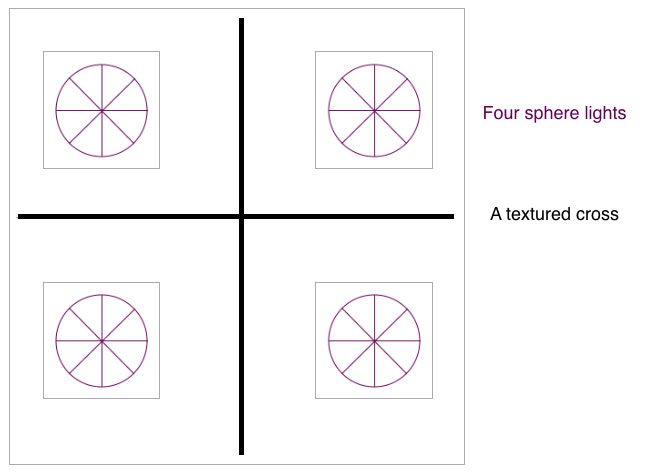

Apart from the glass sphere lamp, the model consist of a bulb shaped object plus two textured boxes forming a cross. And then I have placed four sphere lights like this:
The cross is there to make sure that the glare is not lost when using other camera angles.
I ended up using a cross instead of a cylinder because the cylinder created some weird reflections on the inside of the lamp, and also made it difficult to light up both the bulb
and the glare at the same time.

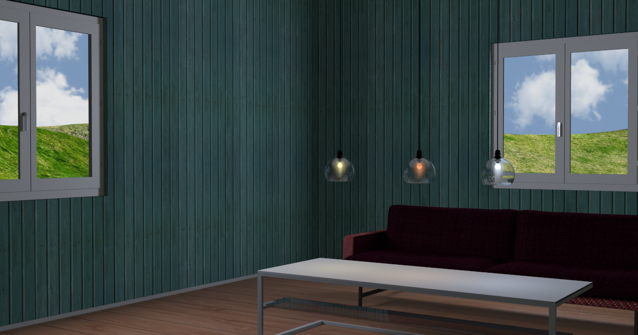

Re: Glare effect
Comparative rendering at night. (unviewable panel above the ground and group of fireglow light source)

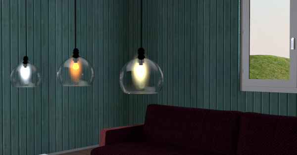

Re: Glare effect
Thank you Enko!
Just a few words:
These lamps are meant as decortative elements rather than stand-alone light sources.
Since there are four light sources inside, the intensity has to be quite low for the effect to appear "natural".
5% intensity:
I think this is a bit too much, but it can work with the fireglow version.
2% intensity
This is my preferred setting.
Cecilia
