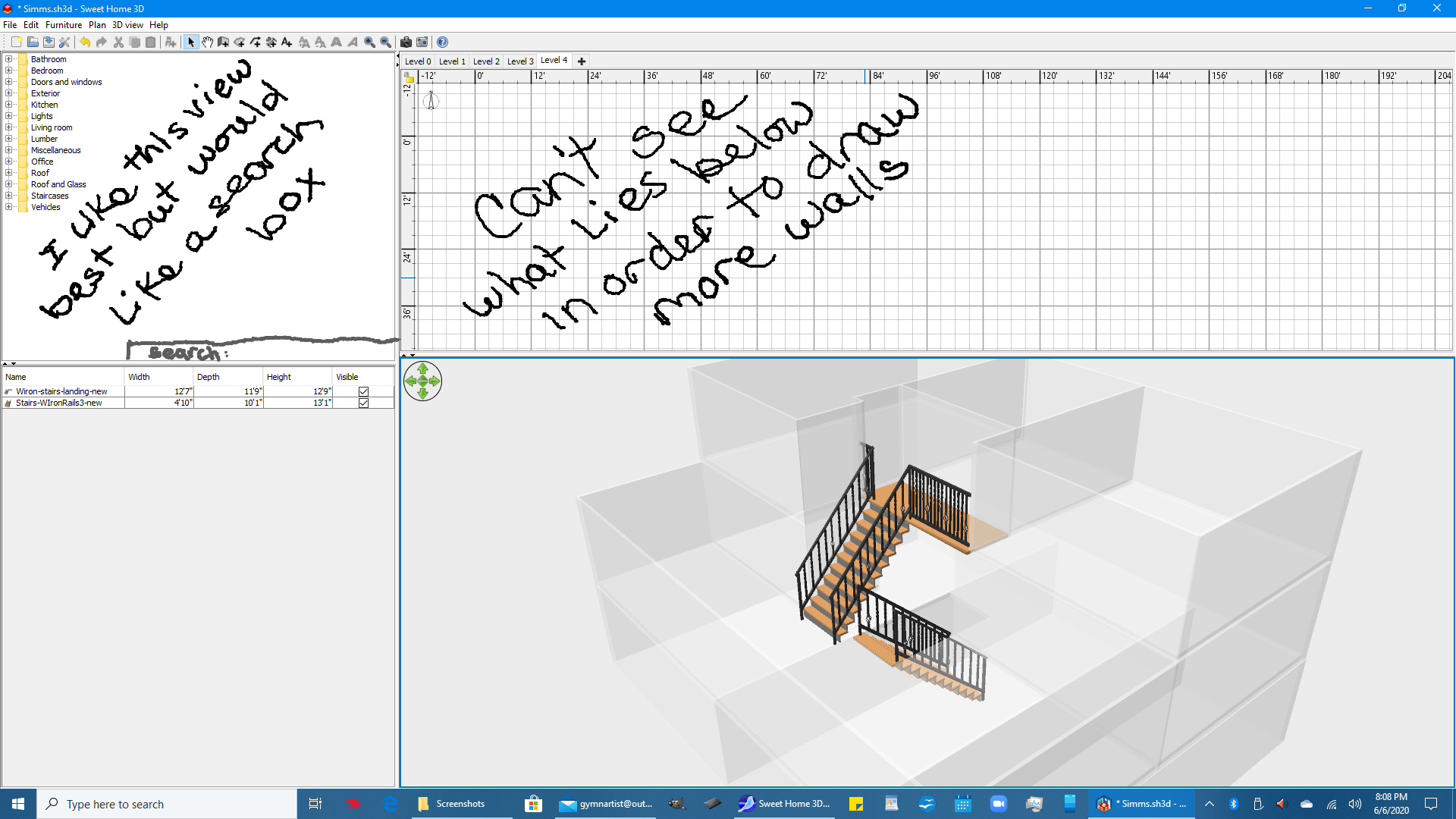

I have a couple of screenshots to show you...
<<If you added the staircase in level 1 before adding level 2, you could have drawn walls at the upper level around that staircase, couldn't you?>> ... I couldn't see where exactly the staircase was.
Attachment Graphpapercantseethrough.png (720134 bytes) (Download count: 68869)
Attachment cantseeplans2.png (302166 bytes) (Download count: 4902)
