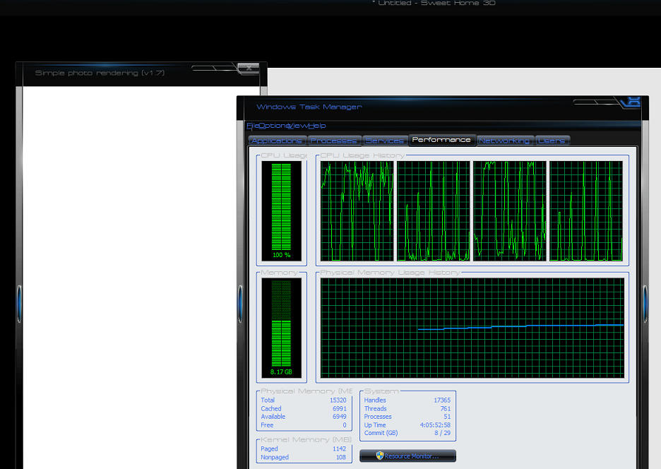

The cpu usage is at 100 % when i normally render but the memory bar graph shows less than 4 usually, including when i checked today.
