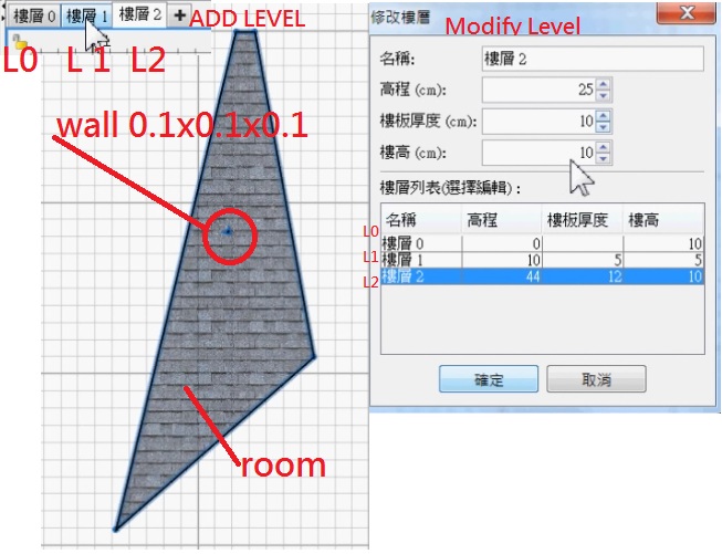

Re: Pyramidal roof download CopyAsNewFurniturePlugin-1.1.sh3p:Here Room cannot CopyAsNewFurniture alone, it must be “wall size 0.1x0.1x0.1 +room” together you can CopyAsNewFurniture. see:Here or Here ---------------------------------------- |
